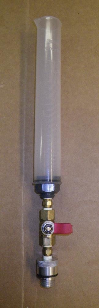

I have always bled the control circuits F&R with my vacuum bleeder. Never had any issues.
The power side I do with a custom made graduated cylinder.
If you have a GS-911 there is a bleed test you can do on the integral brake system to ensure all the air is really out.
