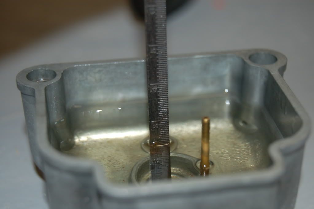

The "float parallel to the body" setting might be a starting point, but Dennis referred to the proper way. You want a certain height of fuel in the bowl. Fill the bowl, turn off the petcock, and then drop the bowl. Snowbum says to measure the height of the gas right in the center of the bowl. For the 32 mm carburetors, use 24 mm fuel height.
For the 40 mm carburetors, use 28 mm fuel height.
I've checked the valves...The float level is 24mm using the method mentioned above...the carbs have been synchronized both at idle and at 3000 rpm.

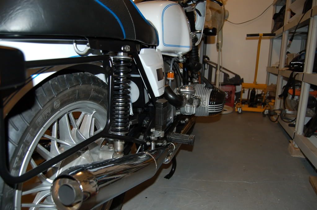

Which leads me to the second...the exhaust. But not that the aftermarket exhaust isn't "tuned" to the carbs, per se, but that there's air leaking into the system. I had seen some blow by when I first restored the bike on the right exhaust at the header/muffler joint, and for those of you who followed my restoration thread...I put the mufflers on the wrong side. So, in the course of swapping them out, I made sure I really tightened the muffler clamp down on the right side. But last night, as I am once again experimenting with the idle mixture screws after I had eliminated the choke levers as a possible cause, I was feeling exhaust squirting out of that joint still. The left exhaust is fine, but the right exhaust is definitely leaking...
Just so happens I swapped the mufflers right around the same time I rebuilt the carbs..
My solution is going to be pulling the muffler tonight, spreading the tube a bit, and inserting a band of aluminum from a coke can to fill the little imperfections that are obviously allowing the gas to get past that clamp.

Well, both mufflers are off, and the popping now is blue flames coming out of the header pipes. Sounds cool though! :laugh
Don't have more time tonight to troubleshoot, but thought I'd let you guys know the mystery continues.
I tried several times to get the joint between the muffler and the header to seal, but no luck there either. even with an old clamp ratcheted down until it almost broke, I can't get the exhaust gas to keep from escaping. But now, that's another problem to solve. The popping still is something to do with the carbs.
