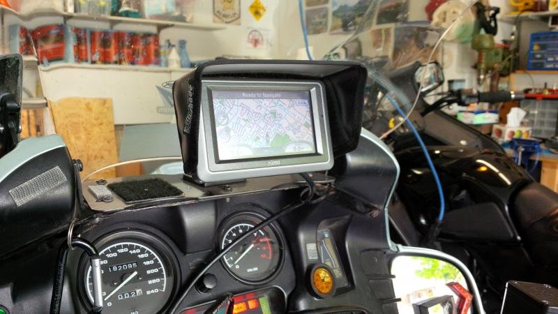

Easy to see the GPS information without taking one's eyes too far off the road.
It was not difficult to wire the GPS directly to the battery, allowing it to be left on when the bike is turned off for routing to the next stop.
May I ask what brand and where purchased is you GPS shade? I've been looking into getting one of these but find mixed reviews on how well they work. Do you like yours?

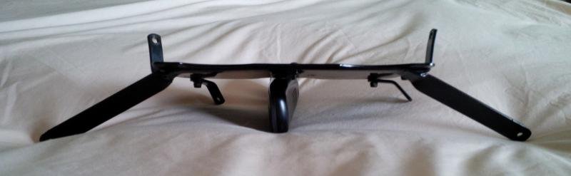

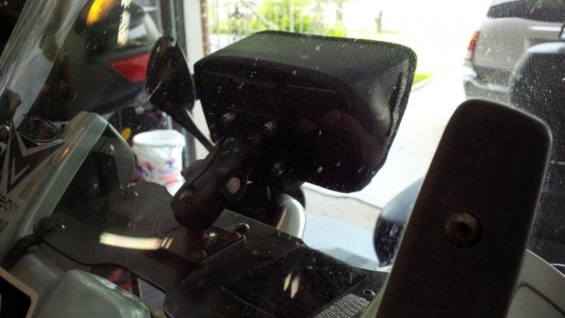

Wow, 182k miles! That's an effective setup you have there. Actually I have a Ram mount attached to the clutch fluid reservoir on the left handlebar. What I was really looking for was a good place to mount a Powerlet power connector. I'd rather not drill into the bodywork so was thinking of attaching a bracket somewhere around the dash or handlebar.
