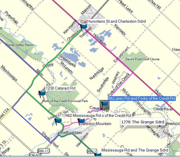

Creating the routes in Basecamp was more complicated that I expected, because I need more experience with it. At first, it looked like I had Routes A and B (titles were unique) but actually I had the same route twice. Eventually, I duplicated waypoints and made one route display in one colour and the other in another colour so I could see there were two routes.
Here you can see two routes. One is the black upper loop and the second is the Blue curvy route that splits off the black route near the top left and goes down on a diagonal to the common end point.
So, I sent these to the Nav V using drag and drop to the SD card. Disconnected the Nav V.
Turned on the Nav V, Trip Planner, three-bar menu pushed, import and the Nav V showed the routes on the SD card. Selected them and they imported.
They look as per the Basecamp routes. I could not get the detailed turn-by-turn listing the way I could with Basecamp by double-clicking on the route and looking into the details on the window Basecamp brings up) but it sure looks the same.

OK, here are 3 routes. Two use only the same start and end point. The third uses an additional waypoint to go through a switchback (there are very few of those in Southern Ontario!). Called Fastest, Shortest, Curvy.
The Nav V is set to Fastest internally.
Transferred all three to the Nav V, and all three were recalculated from a far away point where I am to the same start point. This would give the Nav V all kinds of availability to use the internal calculations ie Fastest.
All 3 routes as made in Basecamp were respected.

Hey, I learned something else today. I checked regarding Waypoints and Viapoints in Basecamp. It seems any points you create is a Waypoint but becomes a Viapoint when you use them in a route. Open the route and right click on the waypoint. The menu will show Edit Viapoint.
Not quite, but we are all learning things.
The route details sheet has a tab that is titled Via Points
. They do it to confuse us. :banghead
But the symbol is the standard waypoint symbol, and the Edit Viapoint dialog does not allow you to do much except enter times, if I recall.
However, you can create a real via point that shows up as a blue dot, quite small and easy to miss, using the Insert feature. When you do this, the detail page will say the point is not announced or some such thing.
The insert button looks like a pencil. After pressing it, you move the cursor, now a pencil, over the route and sections between two waypoints will have a black line visible. Click on the route and a rubber band line will form. Drag the rubber band to some place/intersection and click, move to another place and click until you have shaped the route the way you want.
Check the details page and you will see you have added Via points, not waypoints.
