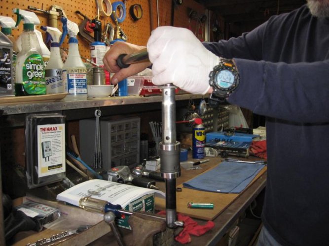

Initial pre-load was done and will be done finally in the wheel...
A helpful excercise to understand the operation of the stack as a unit.

Now, after cooling to adjust final pre-load
