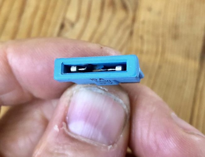

It was just a fuse!
Well, I cannot tell you how happy I am to report that it was just a fuse. I had no idea that a blown fuse would make the instrument cluster go all freaky; I had imagined it would just shut it down, so I hadn't checked it right away... anyway, I'm glad that there were a couple of spares in there, so all is good. Thanks again for the input here - I am learning a lot about my bike!
