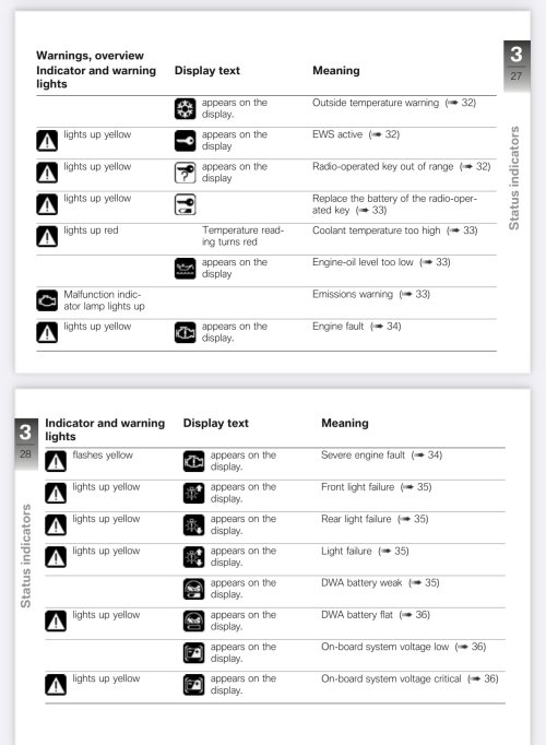

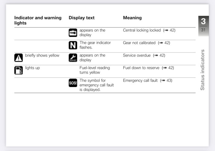

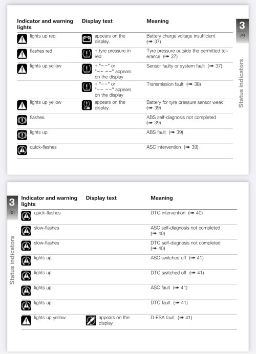

For reference, here is the list of warning signals from the 2018 RT manual. I don’t see anything there that looks like what the OP has described:
