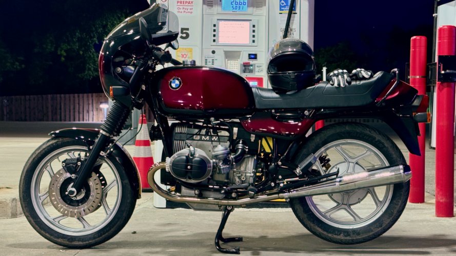

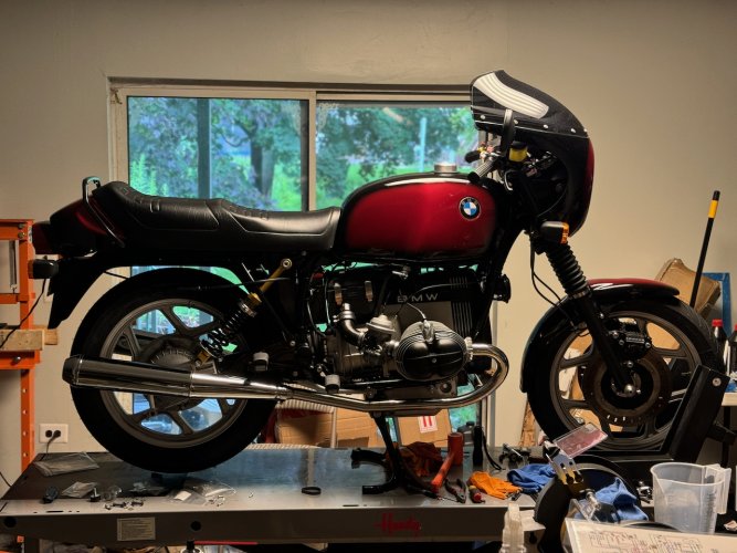

Two years of spare time and I am 99% done.

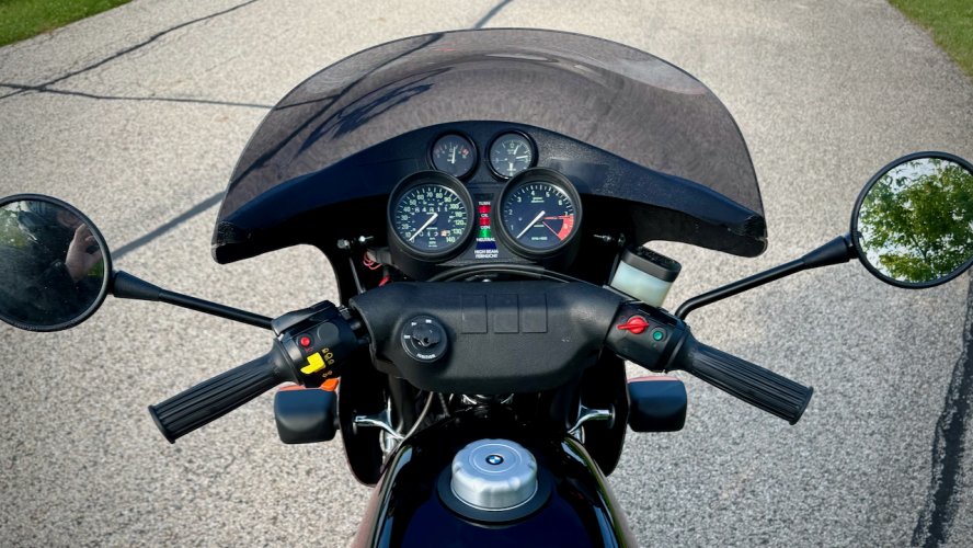

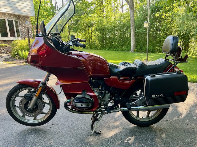

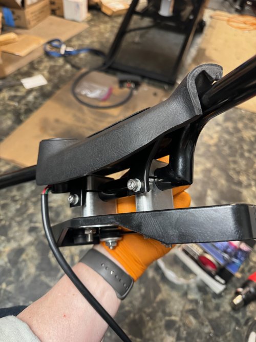

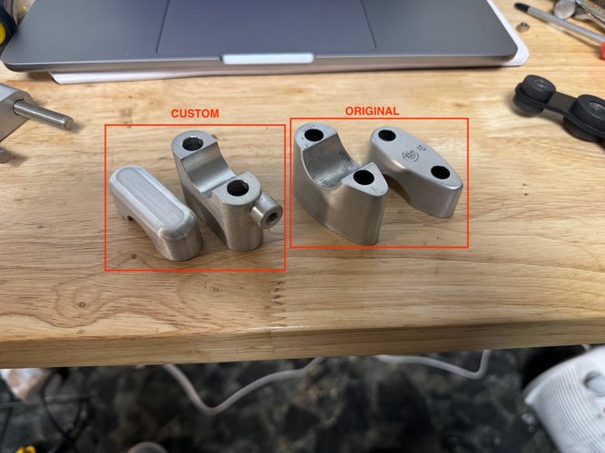

The S fairing is much easier to install. At least compared the the RT, but I imagine the RS is similar there. Regarding the K75 bits, I was pretty frustrated with how vague Boxer2Valve was in their videos where they cover it, so I went a bit deep into trying to get it right.
Two of my posts cover this:

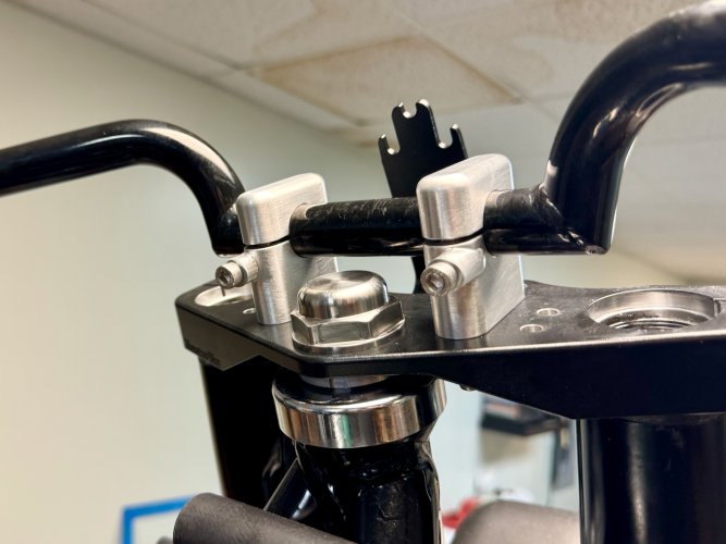

TLDR: I designed and had my own clamps made to allow the bosses for the K75 dash. The plans and step files are here: https://justabill.org/downloads/
They are 6160 Aluminum and I paid extra for a better finish, so a touch on the pricey side at ~$180, but now that they are on and I can get at the screws easily for adjustment, it was definitely worth it to me. If you are friends with anybody who has the CNC abilities, there's only about $30 of metal in these, so it might be worth calling in a favor. This phase of my project convinced me that a mill and lathe are in the future for my basement.
Anyway, I am happy to chat about it more if you want. Just let me know.
Thanks! That's a great idea. Regarding the fairing conversion, looks like nothing is usable from the RT original mountings, right? Did you buy the conversion kit / fairing?
