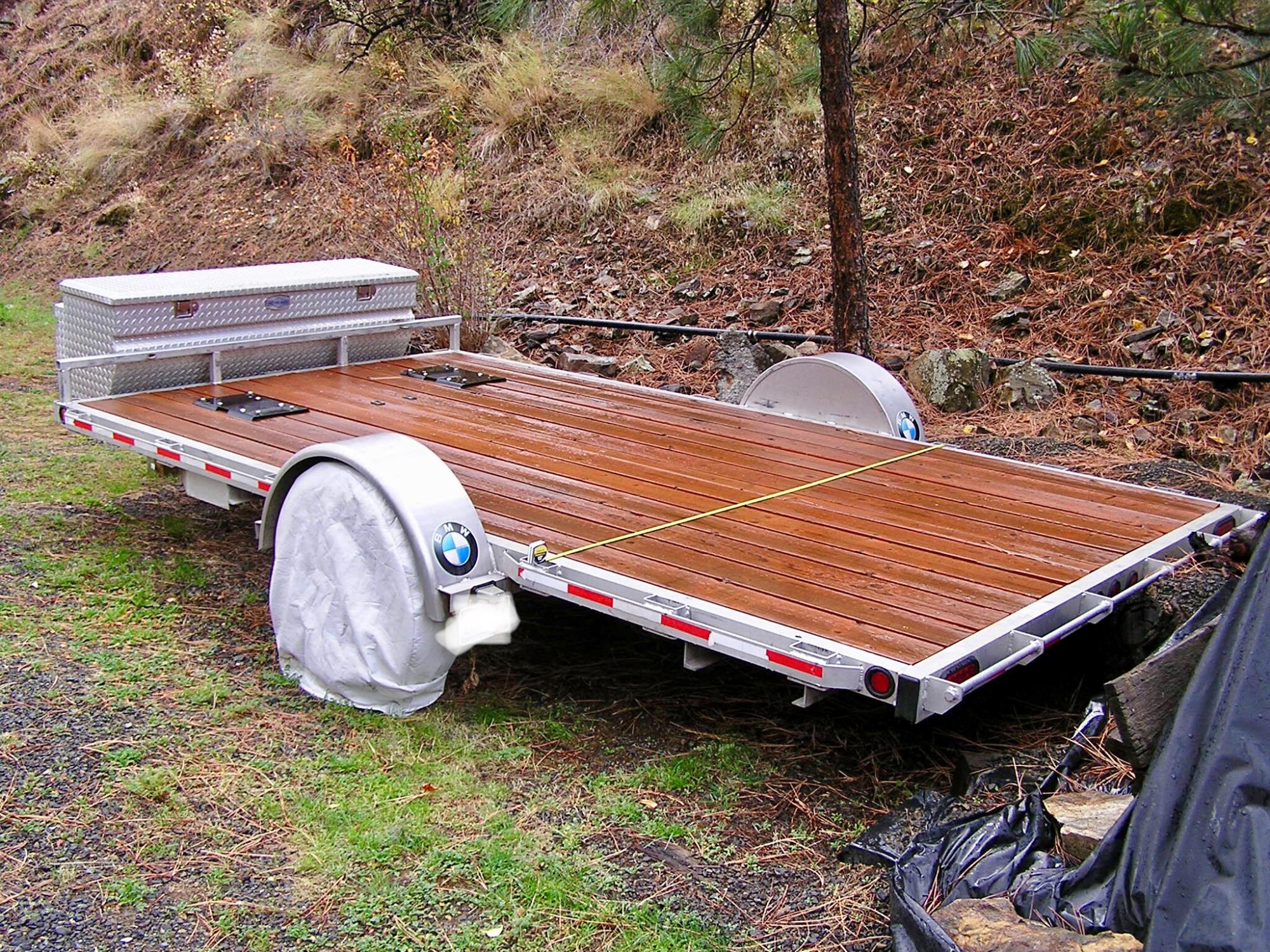

My trailer, 6’9” x 12’ will easily accommodate three bikes. Besides the wheel chock suggested, I like to block the wheels side to side so they won’t shift if I hit some rough road. With a wood bed, some 2 x 4 blocks and wood screws, it’s easy to secure.

That recommendation on the extra blocks is a great idea. Most likely a U-HAUL open trailer will be galvanized steel and might make it difficult. The wood floor generally associated with the “cube-style” may be around that steel deck consideration.

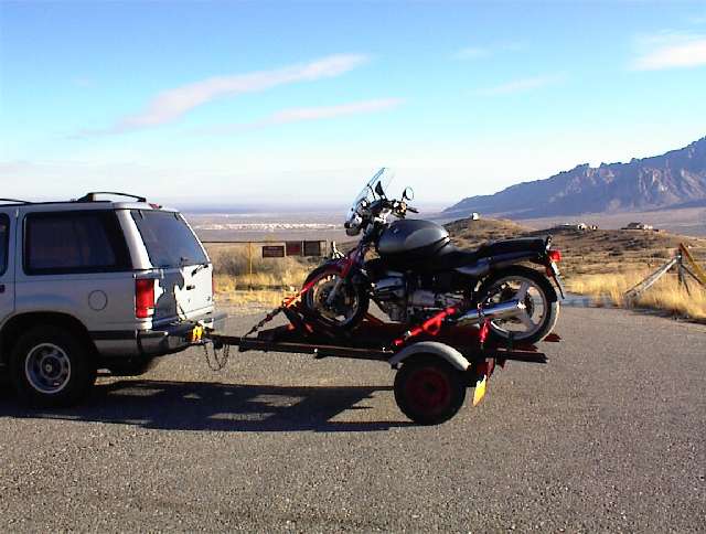

Wish I still had it, but in this pic you'll see my three-rail open trailer. I'm down to two bikes now and didn't feel I'd really need it again so I sold it.
Absolutely a bare bones trailer but perfect for three bikes - and yes, three RT's have been on the trailer [and a lot more over the years]. The center rail is [guessing now] @ 2 feet forward of the two outside rails.
If you could find one similar, Bob's your uncle.
And here's a shot of it hooked up to haul one of the bikes I had in Tucson, home to NM. You can see how staggered the rails on in this shot.
