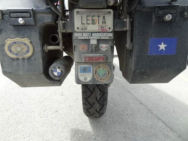

I put a set of Metzeler ME880 B's intended for the K1100LT on my 1150R for an overloaded trip to Alaska.
Next time I will just pack more sensibly. The rear was taller, so I used a longer paralever arm to bring the rear back down to ride height. With correctly sized 888's (if you can find them) this would not be a problem. I should note that my R1150R has a GS suspension and I lowered it for the taller tire by putting the R1150R paralever arm back on for the trip. The bias tires handled properly, but obviously, they are no match for the PR4's. The front tire ran the entire trip to Deadhorse, Inuvik, and back to Georgia. The rear was replaced in Anchorage. Once I got home and took the extreme load off, the comfort and handling showed themselves to be pretty miserable, so back on went PR4's. If you are only mildly dissatisfied, have you considered or tried the PR4GT? Bikes are designed from the tires up. When you change tire sizes, congratulations, you are now the bike designer. Make sure you know what you are doing and are willing to accept the consequences. Your comments on the different front sizes are a bit worrisome.
Tire change in Anchorage...
Back to "normal"...
