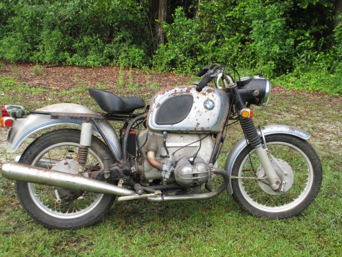

I'm about to purchase a 70's airhead as a project bike. If I need engine work done, is there anyone here from Spokane, Washington that would have professional mechanics they would recommend in the area? I don't know that I need any work done, but I'd like to have some names on tap in case I do.
