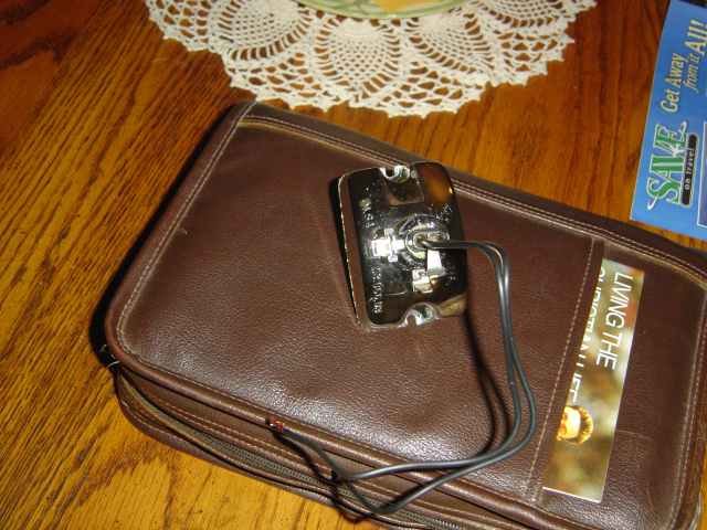

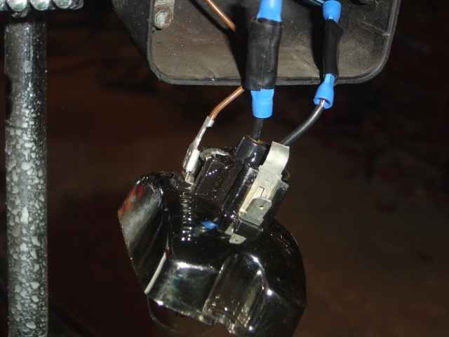

Here's what the rear blinker looks like once modified, before mounting. Three more pix following (don't know why I can only load one picture per post).
Pic #2 - here's the same blinker, wired up.

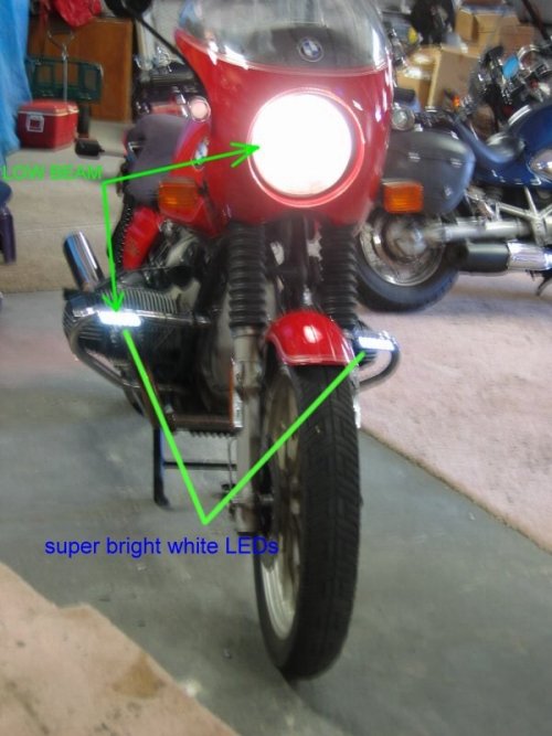

Here's what I've done to increase 'conspicuity' on my R80.
First I used bright white LEDs on the engine protection bars wired with the low beam circuit.

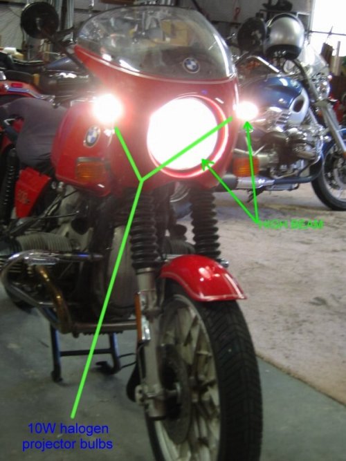

. . . and then 10W halogens on either side of the fairing wired with the HI beam

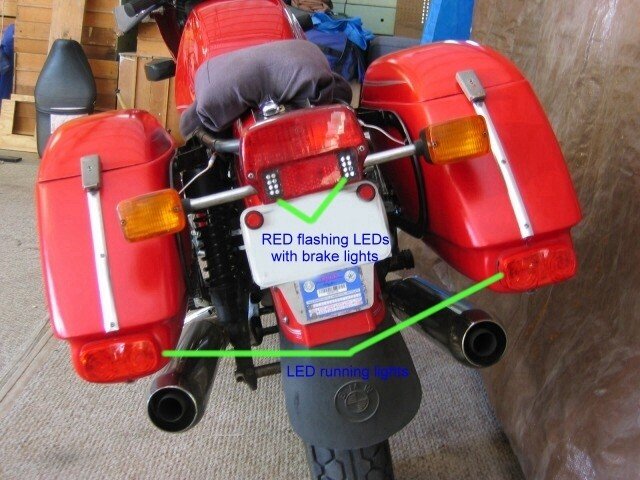

. . . then to be noticed from behind, 10-LED units in each saddlebag wired as running lights; and flashing LEDs built into the OEM taillight housing that activate with the brake light.

Cruisin, Great job making your bike noticeable. Those LED flashing brake lights look very similar to the ones I bought from MotoElektric. I mounted mine on the horizontal bar that holds my turn signals, to get a bit of separation from the main brake light.
thanks, I too, thought about putting the flashing LEDs on the rear turn signal stalks but just like the clean look of having them on either side of the taillight better.

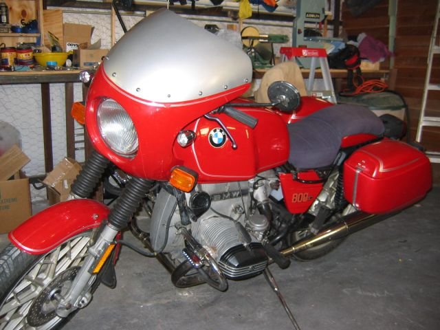

Here is a wider view of the nearly finished project. All I lack now (cosmetically) is a good seat cover to replace the temporary denim one used during testing of various foam shapes & thicknesses.
