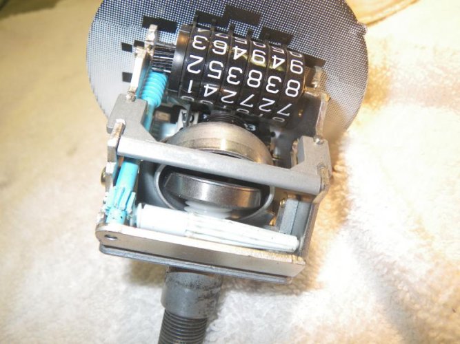

More details as to model needed. If it's and oilhead one:
The gear needs to be changed for the odo and trip meter to read correctly.
The metric one is blue, the miles one is green
Google the subject, I read some detailed info a few years ago
Metric one shown below
