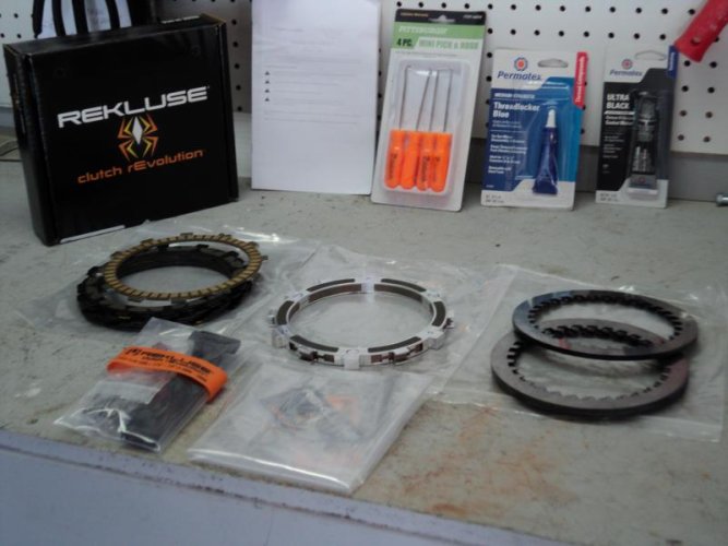

As requested, here is my review of my recently installed Rekluse adventure EXP auto clutch upgrade, which turns my 700 into a semi automatic motorcycle. The Rekluse clutch system seems to be a well know assessory to enduro dirt bike racers as a racing clutch, but probably not so much to non-dirt bike racing folks like myself. At the the urging of fellow GS Giant rider Monty Alterman from Kansas City, (after stopping with him to look at a new DCT African Twin during a rain delay ride recently where Monty suggested the Rekluse) , I decided to give the it a try, since it seemed like it would be a great solution to my increasingly arthritic left wrist pain. Gateway BMW has been fully supportive of trying this out, as it seems that I am one of the first to consider it for the twin cylinder 800 series, (at least from their dealership) so I had solid support to give it a try. So, I ordered the kit, and here is what comes with the clutch:
In the package there are 12 steel plates, (3 thick and 9 thin) 1 thick friction plate, 9 thin friction plates, one EXP pressure plate, and a packet with miscellaneous springs for customizing the EXP pressure plate, a thick rubber band for use when adjusting the clutch, decals and a couple of Velcro tie straps, and of course an install instruction book.
In the background, I also show a set of picks (Harbor Freight for $2.89) a tube of Blue Loctite, and tube of liquid gasket seal, just in case I needed to patch up the gasket until I could order a new clutch cover gasket, if needed. (I didn't, and glad of it, as it's a $30.00 gasket).
Everything needed for the clutch is included in the package, including the two thicker steel plates and one thick friction plate that in the official Rekluse install video, states that the OEM plates will need to be reused. The video is an excellent description on how to accomplish the change-out, so I didn't do a step-by-step process layout, so a quick review of their video will answer any and all questions of the procedure. I will say it was a pleasant surprise to not have to reuse any friction plates from the OEM parts, since they caution not to use the OEM friction plate if it is worn. My research found that individual plates are not available to purchase from BMW, so it would have required me to purchase the entire clutch assembly in addition to the Rekluse assembly if my thicker friction plate was bad.
