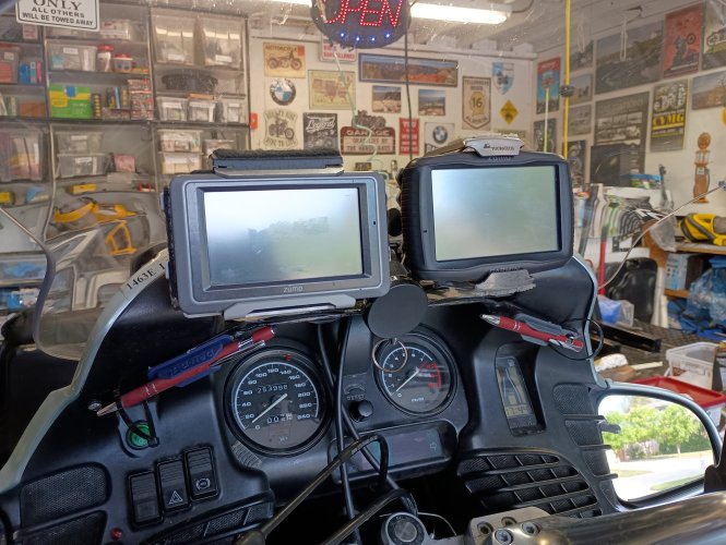

On my R1100RT, I have a shelf and have two Tourtech locking mounts for my reliable Garmin 660 and the Garmin 595. Both are at eye level. Unfortunately my K has the 595 mounted on the handle bar; not as easy to view.
I do no know if a shelf is available for your bike.

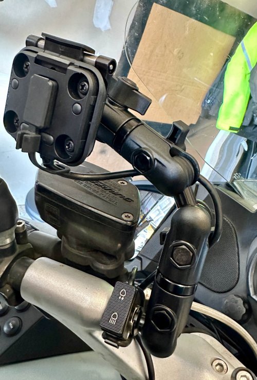

This is for a Garmin Zumo XT2, but could also could do the same with XT or any GPS that uses a 4 bolt standard AMPS mount. Tackform BMW bar mount and several Tackform arms to allow adjustment and positioning over clutch reservoir. This is using Tackform's anti-theft arms and a MotoPumps security mount to prevent casual theft of GPS. This is on my 2010 RT.

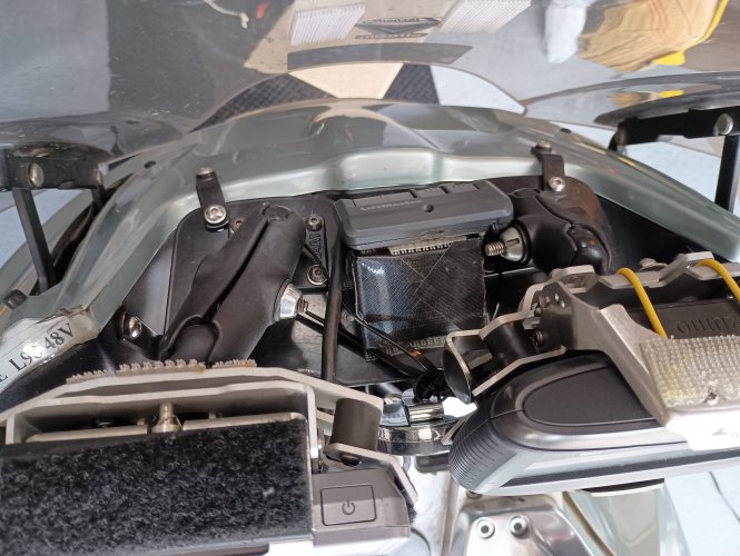

I should have included a pic of how my GPSs ate mounted to the shelf from the rear view.

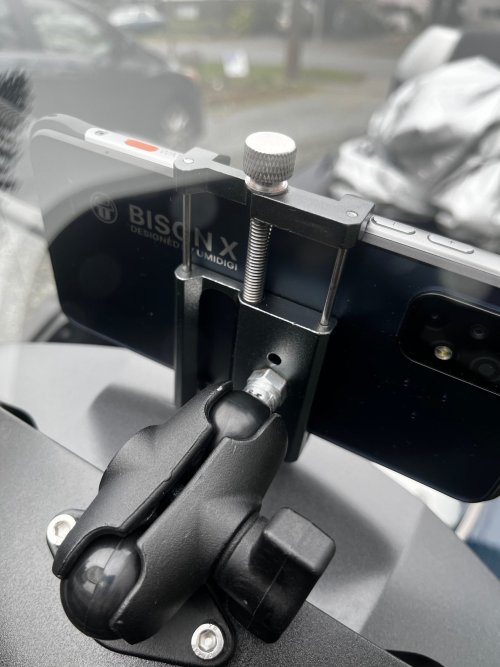

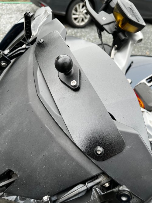

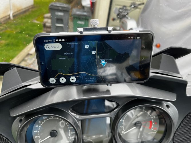

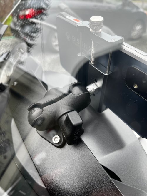

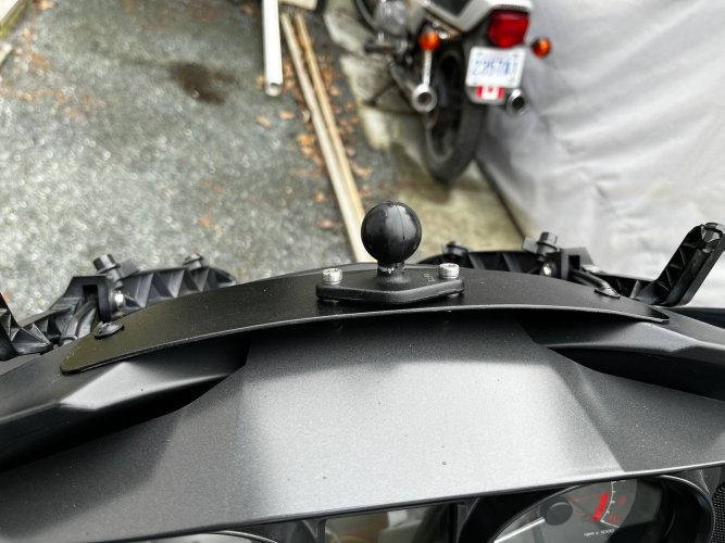

Here's my GPS mount on my 2013.
Custom mount made from aluminum powdercoated black, Ram ball and short extension arm. Umidigi Bison X10 rugged smartphone running TomTom Go app. Works great.
