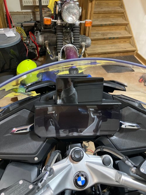

I originally just used a ram mount and Telforizer for my XT but now I use that for my quadlock.
I'm now using the FMS mount and RFT shield to keep the GPS in my sight line better.

I am wanting to do the same on my 22 RT. Did you use BMW part #65901598845 navigator mount with the FMS kit? Thanks.
Hi - that is the GPS kit for the F900’s. I used a cradle from my 2023 R1250RS. That said, I believe the only differences are in how they mount to the specific bike. In my case, I only used the mount body. I doubt it makes much difference which model you use, as the body seems to be universal.
I'm not sure that he was asking whether the BMW mount is _necessary_. It is not. However, I used the BMW mount so that I had a _lockable_ GPS mount for my XT2, and that may be why he was asking about the BMW mount.
All I have is the Nav VI GPS itself. No cradle or mount. I got the Nav VI with my ‘17 RT that had the cradle already in place. I’m trying to figure out if that part # is what I need in addition to FMS’ parts to install on my ‘22 RT. On my ‘17 it was not lockable but on my 900XR it was. That is why I wanted to use the 900XR mount/cradle.
