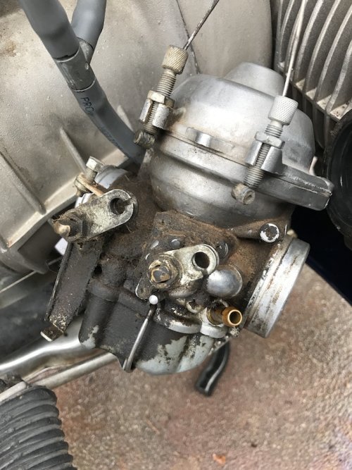

When the bike got here, I'm glad I didn't try to ride it back from UT. The tires were seven years old, the push rod tubes were leaking, the cylinder head stubs were loose, the turn signal switch was intermittent. The carb bodies were so filthy, I had to use a plastic paint scraper to get the first few layers of hardened UT dirt off them, hit them with S100, Foamy Engine Bright, Simple Green, and then ran a few cycles in the Ultrasonic Tank.
