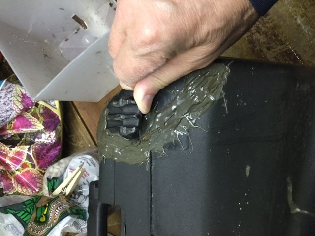

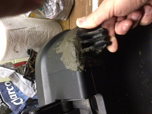

Here are two pictures. The owner before me slapped some gorilla glue on it. That did not last 50 miles with the bag empty! As you can see I don't have much to lose. -Neilg.

If it were mine, I'd start looking for a replacement on ebay (damaged lid on a good inner 1/2 as mentioned above) and in the mean time I'd...
1- grind off the epoxy mess
2 - melt it together with my ski repair iron
3 - drill pairs of holes along the crack and stitch it together with safety wire (or use a hot staple gun instead)
4 - melt more plastic over the safety wire to strengthen it some more and seal the holes
_____________________________________________________________________
making a reinforcement plate and riveting in place is another possibility

I agree with:
1) Looking for a replacement, and 2) making a repair plate. Ugly, but probably the only thing strong enough to hold the loaded bag on the bike. You can get waterproof rivets. Use those with some heavy aluminum sheet cut and shaped, then spray your repair black. It will be at least as attractive as the current repair :)
Thanks for all the ideas. I like finding a replacement back half. Also will try a backing plate w/ rivets and the appropriate glue. Maybe I can work the safety wire stitch idea into the fix too. Thanks again, -Neilg.

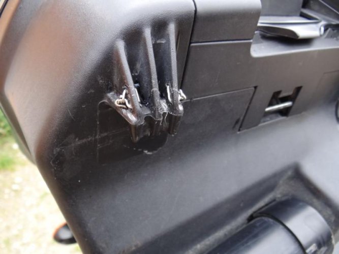

SS wire stiching
I did this repair in a hotel room in Alaska. Used a Bic lighter and melted the holes.
Glued the piece as well with Gap filling cyanoacrylate (crazy glue)
Its held up for 2 years (many times fully loaded) and still very strong
