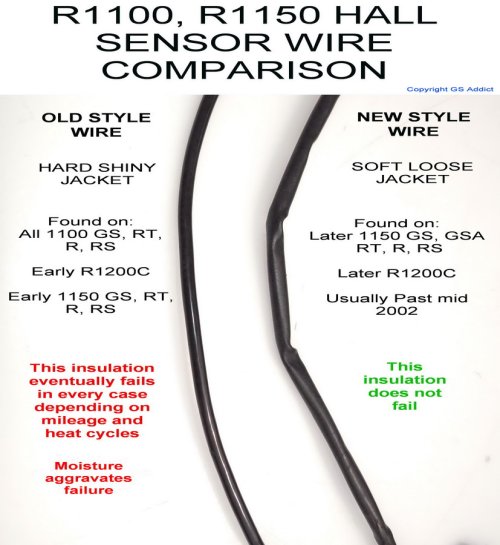

HES could be an issue but I would start with the basics of a good tune-up. Starts/runs for a few days then no start?
A good tune-up starts at the battery, fuses, ground wires and so on.
What year r1150R?
See below re Hall Sensor
