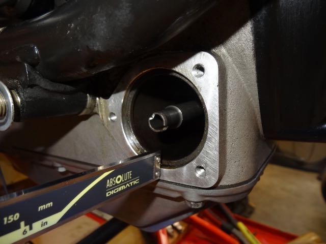

Sorry, on your '77 you need the shim. Its purpose is to protect the o-ring from the sharp edge of the filter canister and frankly simply to give the o-ring something to seal against.
In the mid to late 1980s, these engines began to feature filter canisters with folded over edges that provided the flat surface required for o-ring sealing and protection. You didn't need the shim on these models.
I'd be interested to see official BMW publications addressing the need for shims to adjust for canister depth ... most of this is I think and invention of a few gurus and I can say I've never seen the need.
No, you don't use the paper gasket on anything newer than a /6.
Kent, I know you've said this is the past and generally it might be true. But I can attest that in my situation, with a canister that is somewhat close to the engine surface, I need a gasket, in fact I run two gaskets, in order to shift the cover away from the block to allow room for the o-ring to reside without getting super crushed. Yes, I use the metal shim. So IMO it is not a universal statement that anything newer than a /6 doesn't need a gasket. To borrow a thought from the past, "Trust but measure to verify."
