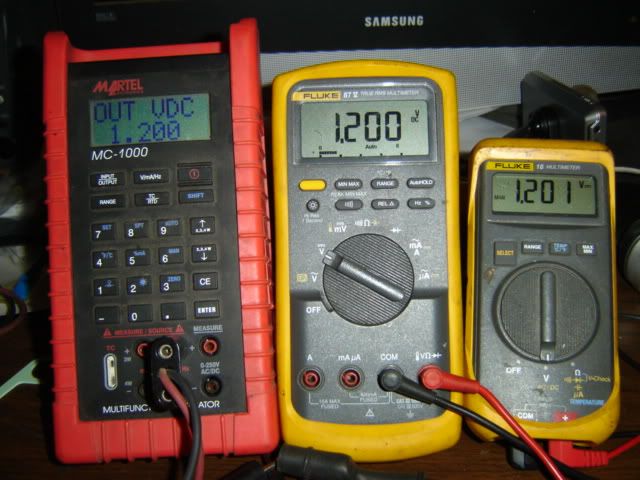

a good way to check out your meter: go to a HVAC supply that stocks Fluke 87V meters. take a 3v lithium battery for a stable test source to check your old meter.
here's my Martel MC-1000 putting 1.2v test volt. Fluke 87V and Fluke 16 shows calibration is within spec's.
