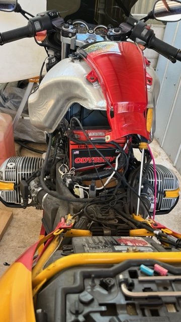

The 1100 S had a set of tires scheduled to arrive Thursday and were delayed until today, the current set is ready, I had also ordered a battery when I ordered one for a bud preparing for his CO trip. The battery in this bike was a 2016 Odyssey, but still doing its job and rotated in charger dance in our shop. I rolled out at 9:30 with a smile. Stopped at bank and the ATM decided it was a good time to shut down with my card inside! I went inside after shutting bike off and spent a bit of time getting my card back and some cash for the day. Upon gearing up, hit the starter to have lights dim on display and nada :banghead
Waited a few minutes, same result so a push start downhill looked like best plan.(my jump pack is in GSA side cases of course) Some bikes easier to mount when pushing and this one not one of them. After three tries I retreated to another wait. Luckily it had enough oomph to fire and I rode short distance to inspection station, leaving bike running and on my way home in short order. Fine, will wait on battery and tires and ride this one next week… Got on H’s 390 KTM and entertained passerby’s with my 6’1” frame on orange rocket. The inspector even chuckled when I rolled up….back to the house for the 690 big brother and my ride for the day.

. Now have wheel off KTM to patch internally , bodywork off of 11S( prob the most difficult model to change the battery for those who own one know) That’s when I saw the date on battery as well. :laugh

Follow up, tires on and mounted, battery tomorrow. My luck continued it seems but maybe a good way. As I prepared to remove rear wheel, I did the wiggle wiggle to check pivot bearings and FD health… could lift paralever up about an inch in an odd feel. What?? The torque link I have never touched was loose at transmission! Really loose as in a few threads shy of losing the nut :eek
On this model, of course, the belly pan, Staintune exhaust mounts, and recessed outer bolt head of front mount for torque link required a thin 16 mm socket, and a tight box end for the exhaust bracket obstacle on the nut. Anyways, so glad I found that !

On batteries, since the oilhead charging system doesn’t do justice to the Odyssey’s preferred charging parameters, they just don’t last , though I had two to ten years as well. I know I can tweak the alternator, just rather ride it and rotate tenders. It had been cranking fine and ridden twice in the last month. I put it on big Odyssey charger and it went through all its conditioning showing good to go, will load test later, but it’s not going back under all the covering on the S
