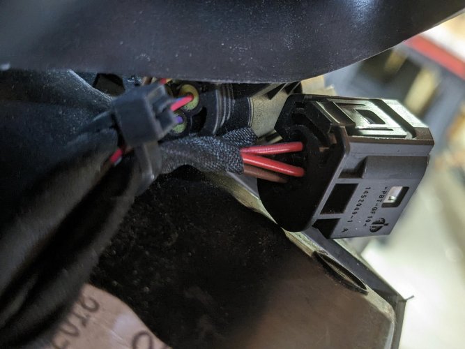

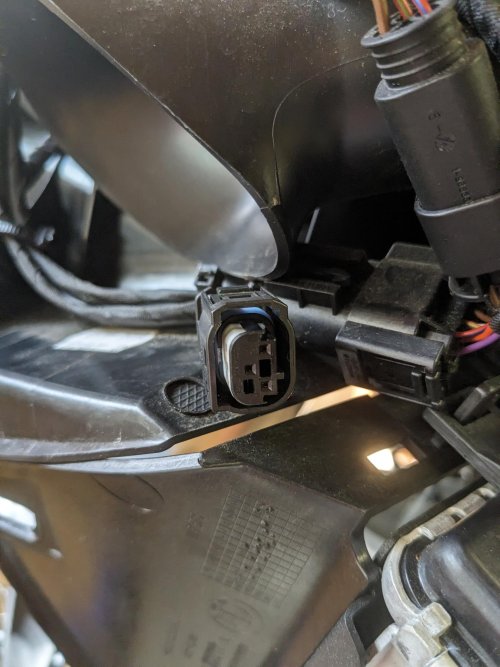

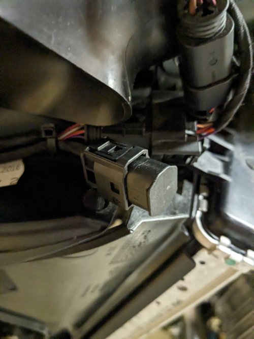

I'm hoping to get some help with my (new to me) 2019 GS. I've removed all of the bodywork as I install a few accessories, and have noticed an empty electrical connector on the forward LHS of the bike, just below the LH air intake and above the left radiator (see Photo 1). I don't *think* this is a provision for a GPS since the bike is equipped with the GPS prep kit, whose wiring and connector I've located on the RHS. I'm also thinking it's not a provision for auxiliary lights since the bike has those wired in already as well. Photos 2 and 3 show the front and back of the (3 wire) connector - it also had a weather cap that I removed for the photos.

Can't tell the gauge from the pic, but the wires look like they can handle some current. There is also a BMW silver label further up that might have a part number on it. Maybe for a second rad fan in very hot climates? Take a DMM to them and see if there is power or ground.

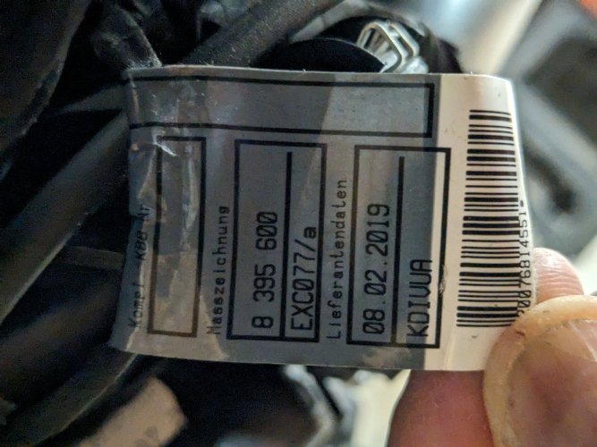

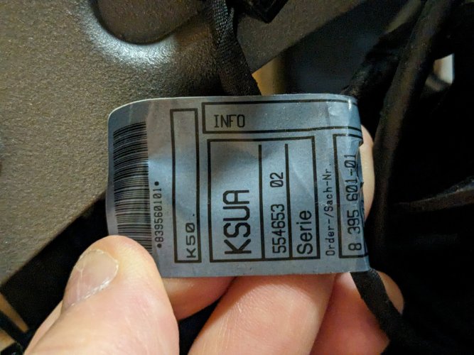

For Globalrider - I have the battery disconnected for other things right now, so no way to run a meter. That said, I'm assuming the brown wire will be ground and one of the red (or red w/stripe - to be honest I can't discern what color the stripe is) will be power. I've added some photos of the silver label, but I've had no luck so far searching the part number (which I assume is the 8 395 601-01). I've also added one more photo of the connector, this time with its weather cap.
