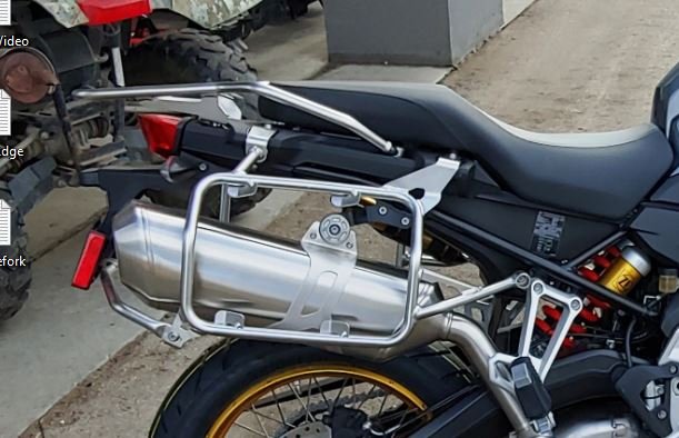

What I have not liked was their mounting system. When the bags are off the bike, the mount blocks access to the back wheel, and if you have been riding and they get mud or dirt on them are often hard to side the bags off and on. The locking system on the version I have is located in a position that often leave me with a barked hand with trying to lock or unlock.

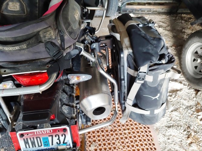

The other day I saw a blog posting of a new F850 GSA owner which had replace this mounting system with the Giant Loop soft bag mount and the result really caught my eye. GL soft bag mount fit the R1250 GSA & F850GSA mounts. I had one on order that same day. GL is in Bend OR and I had my new mounting system two days later.
Giant Loop’s award winning Pannier Mounts offer greater adjustability in the ultimate quick-release, lockable solution for soft luggage and gear. Combine with Round The World Panniers, MotoTrekk Panniers, Rotopax gas/water cans for installation on many popular side luggage rack systems, including Yamaha Ténéré 700 OE, KTM Powerparts, Royal Enfield Himalayan OE rack, Indian OE single-side luggage carrier, Bumot, ADVM X-Frames, Touratech, Brooks AutoSports, Givi Outback (2019 and earlier), Outback Motortek, Hepko & Becker (Standard and Cutout) and BMW R1200 GS Adventure, BMW R1250 GS Adventure and BMW F850 GS Adventure original equipment. Will not fit BMW 800GSA Factory Side Luggage Racks.
https://www.giantloopmoto.com/

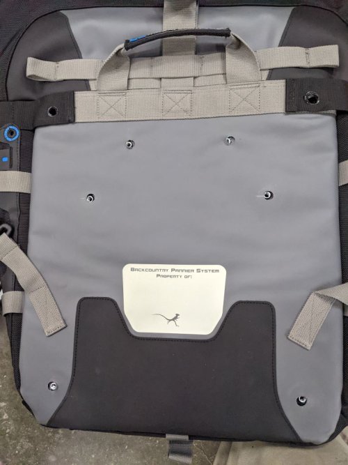

Once out of the box, you should take the mounts out to your bike and adjust them to fit your specific rack. On my GSA there are tabs on the rack that interfered with the lower mounting loops. So I move the lower loops to a different location on the mount and adjusted the spacing for a perfect fit. The GL mounts and the bag mounting screws don't line up as the mount is smaller than the bags. An intermediary layer is necessary to mate up the two systems. I used the bag part of the Moskomoto mounting system, but a sheet of aluminum or every a 1/4 piece of plywood would work fine. It took me a couple of hours to complete the work and I am very satisfied with the results.

I like the idea of the GL bracket. This answers several questions but one. Were you not able to mount the MM 35 directly to the GL bracket without the MM horseshoe plate on the back of the MM 35? I see your note about the intermediate layer but, can't you just use the hard-plate inside the MM 35?

Not sure if you are still looking into this, but I am going in this direction with my new bags. I wanted to add the Mosko soft bags to my own GSA, but also want to keep using my Adventure cases at times, so this was the perfect solution to not have to do a lot of work to switch between them. I ordered the bags without the mounting plates which saved a lot off the cost. That was about evened out with the cost of the GL brackets.
I found I can use four of the Mosko bags existing bolt locations by drilling new holes in the brackets to match. I then made two new holes in the bags to match the top holes on the brackets. Only issue I've run into thus far is the supplied bolts from Mosko are a bit too long for the thinner aluminum brackets so I have some shorter 10mm ones coming from Amazon. I am also going to make an aluminum bar to span across the top two bolts in the bags to add some support there. Those will be 1 1/2" flat aluminum 14" long.
