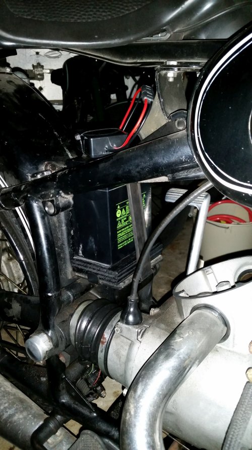

As for lithium battery, not sure why the need to push for that kind of tech on an R50. I wonder if the charging system will do it justice...can't be that you're trying to save weight!! I had issue with a similar battery on my R69S but ended up going with a sealed battery supplied from then Bench Mark Works (no longer in business, parts sold to Max BMW). It's a non descript battery probably something that might have been used in an old uninterruptible power supply. It has two spade connectors, so I had to rig up a small box so it will mate with the bikes existing wire loom. I ended up using some trailer wiring with quick disconnects. Here's a view of the battery in my bike...I had to sit it on a piece of plywood to let the battery hold down strap do its job.
