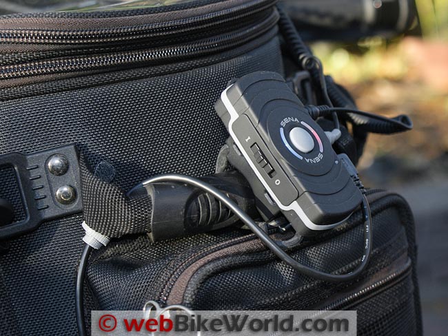

Have you tried the Sena SM10? It is a 2 channel BT transmitter. I used one and am very happy with it. I keep mine inside my tank bag. I have the output from my radar detector and an iPod going to it, and it works very well. http://www.webbikeworld.com/motorcycle-intercoms/sena-sm10/review.htm
I have not tried the SM10 product but I am using the 20s with good results overlaying intercom with streamed music.
