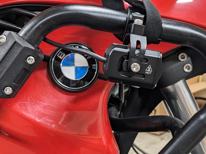

I've tested & evaluated several sets over the last year and I had set aside a pair of Kewig LED lights but when I bench tested them they were drawing far more than the stated 60 watts a pair, they were actually close to 60 watts each. Since then I've found a subsequent set of Kewig, the model K11S, that draw 30 watts each and they went on the bike Saturday. Three flashing modes, plus amber and white, good spread, definitive upper cutoff and a nice harness and fittings.
