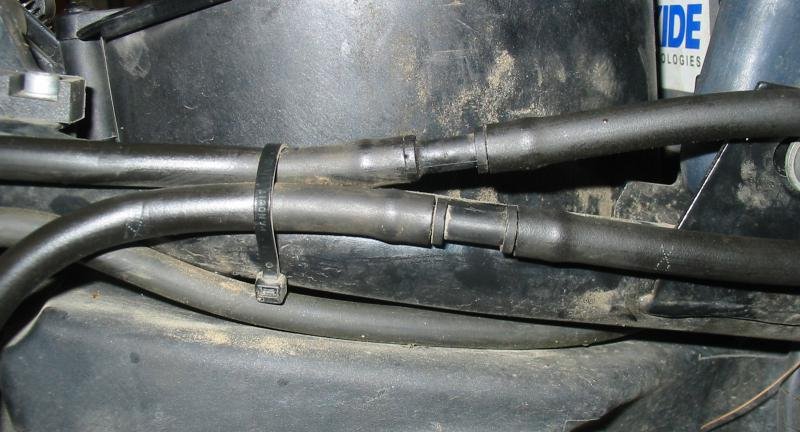

Took gas tank off for first time today. Everything went well except I overlooked unhooking the two vents hoses from the tank. The drain hose pulled off in the middle of the bike and the one that goes to the charcoal canister disconnected where it was supposed to (where the zip tie goes). This is probably a stupid question, but does the drain hose hook in to anything on the other end? In looking at the end, it has a bulge like it was hooked in to something. Common sense tells me this gets tucked down by the right foot-peg with the other drain line
In the top picture, it's the hose on the bottom. In the bottom diagram, its the "H" hose.
Drain lines
If charcoal canister fell off and lines rerouted and other ports properly plugged, we won't tell EPA on you.
