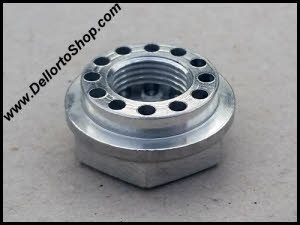

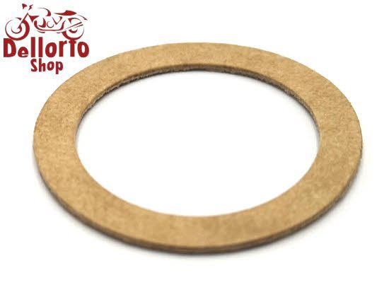

I'm trying to solve an issue with only one Dellorto on my R90s.
For some reason, only the left side float bowl leaks/drips at the nut. I'm using the stock 21mm gasket and nut.
I've tried three different gaskets, and all of the surfaces are clean.
Maybe next step is applying some fuel resistant gasket material but thought I would ask here first.
Thanks,
(90) 21 mm Float Bowl Nut for Dellorto PHM carburetor 10238.jpg(89) 21 mm Float Bowl Nut Seal for Dellorto PHM carburetor 2778.jpg

I went through my Dellorto parts and found an early style float bowl (Float bowl nut is smaller) and installed the bowl with the older nut and new gasket. Rode about 100 miles yesterday and the problem is solved.
