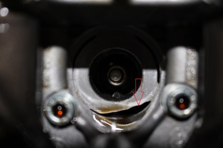

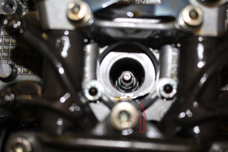

R1150R with 37k miles was running ok but developed oil leak out of right cylinder head spark plug recess. I pulled the valve cover and found what appears to be damage around the casting where the spark plug screws in (see arrows in photos). Has anyone seen this before? Looking at a parts schematic I don't see any separate components in there, it all seems to be part of the head casting.
