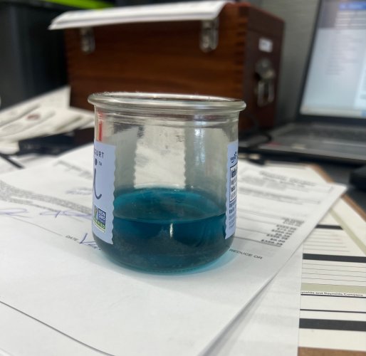

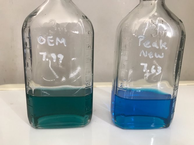

My 2020 R1250RT has 20k on it. My system coolant pH is 7.99 (i have luxury of a meter, not paper). I showed my coolant samples to the BMW Dealer who said the color and pH are spot on. Attached two photos: one is the dlr new out of the bottle coolant vs. my system coolant and Peak coolant. The dlr has only ever changed coolant in a couple bikes due to other work performed that required a coolant drain. Dlr further said they like to flush the system at 10 yrs or color/pH change. Acceptable pH is 7.5-9.0 but like it to be closer to 8. Oh btw, Peak European coolant has the correct ASTM D3306 certification...but is definitely a different color.
