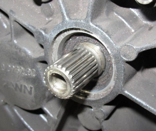

The splines haven't been seen for + 50K mi when last the clutch was replaced (Valentin motors in Greenlake). Plan on doing it my self (now that I have a lift!). Is there an idiot guide for that procedure? What is the best lube, now that Guard Dog is NLA?

In regards to the spline lubrication, I did mine about 18 months ago and found this video by Chris Harris to be very helpful (as well as entertaining). I was lucky in that my splines were dry but in good shape. I ended up use the original Staburags lube since it seemed to work pretty well for 75K miles on the first round.
https://www.youtube.com/watch?v=6gzR4WHD-94
Hope this helps...
Pat
