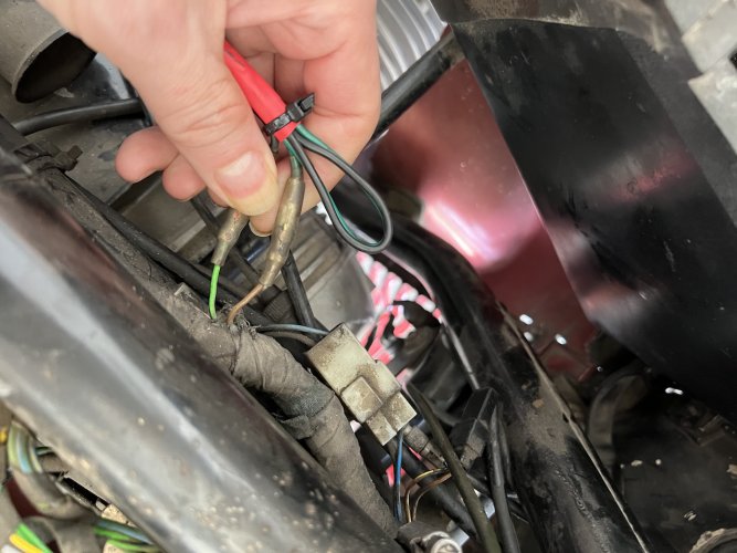

I have removed the aftermarket radio and cigarette lighter. The cigarette lighter was wired into the chassis harness (pic) and the radio also powered from that.. I think this is switched accessory and ground.
So now these have no home. Not sure what they should connect to. I don't think they are the source of the issue I am having. Anyway, while I wait for my copy of Clymer to arrive, I thought I would see if anybody had thoughts.

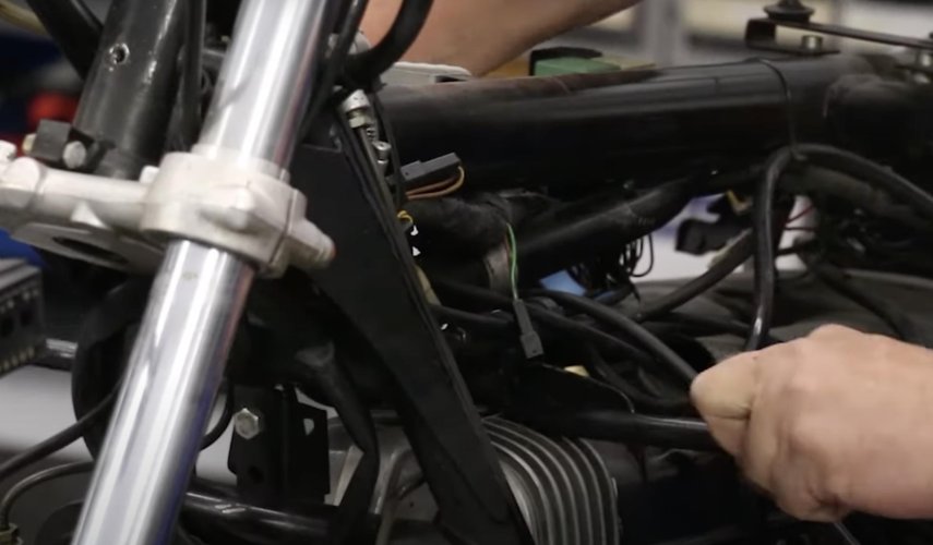

Oh, those two wires appear to be a simple accessory switch looking at a video from Boxer2Valve where they convert an '85RT to an S. Easily seen with a connector in this bit of the video. Less to worry about for now, I think.

My diagram doesn't show accessories specifically for an S-model. It does show an accessory connector with a ground and a green-black wire (among other wires). Green-black is indeed switched power. Is that the color of one of the wires you showed in the first post? Of course, you could verify that by hooking up voltmeter to the two wires and see what you read with power off and on.
