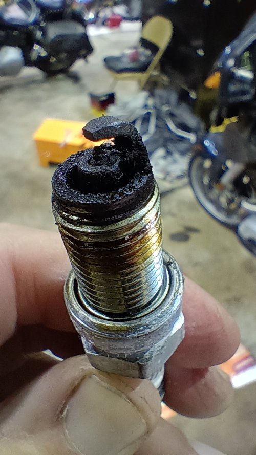

Just picked up a well-used 07 R1200RTP and was checking the plugs. There was some telltale power surging at lower rpms, which led me to question the condition of the secondary spark plugs. Mind you, this bike was allegedly getting dealership service.
Glad I checked. The fasteners down there were frozen shut, and it looked like the secondary plugs hadn't been changed since the bike rolled off the assembly line.
Instead of iridiums I'm trying an alternative from E3.
With that kind of crapatation buildup, I'd be surprised if they were firing at all, and if they were, it would be pretty weak.
Are you willing to disclose which dealership...?
It was BMW of western Oregon, but now that I think of it, I'd want to go back through the receipts and see if it itemizes how many spark plugs were put in for the job. It came with the maintenance record from 16K to 58K miles from the dealer, then no records from there to when I got it at 75K miles. It is possible that the plugs could have been changed way back when, but from the condition of them and the frozen fasteners I didn't think so - my opinion FWIW.
The engine performance was much improved with 4 new plugs.
