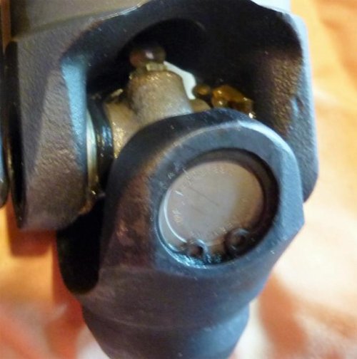

As you can see in the (fuzzy) picture the grease nipple on the u joint is already installed and angled in such a way that I believe you could lube the front joint by just pulling back the boot. Though I will note that the manufacturer claims the U joints are sealed and don’t have to be lubed. In addition there is a large clip holding the dampener section onto the shaft and if you remove that you get access to the dampener pads that are also replaceable. I didn’t see a kit for this particular shaft but assume it would be priced similar to rebuild kits for the existing models.
