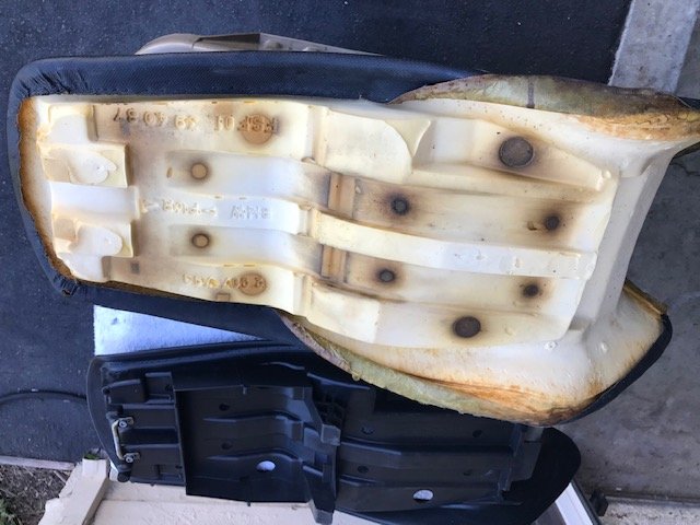

I purchased a inexpensive trashed seat from a '03 K1200RS at a motorcycle salvage yard after checking that the base was clean and undamaged.
The base was in good shape and cleaned up quickly.

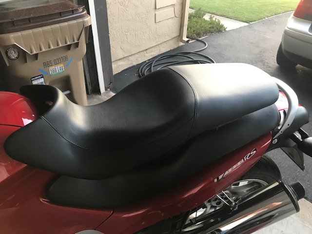

Today I dropped off my good, original seat (to use as a reference) and the salvage yard seat base with it's old foam at Legendary Best Motorcycle Seats in Ventura California.
Adrian will shave off and use the molded rectangular foam shapes on the bottom of the old foam to insert and glue into the channels in the molded plastic seat base to provide him a smooth surface to build on.
With his advice I picked out some multi density (3 layer) foam and an untextured black cover material. Adrain explained how making the cover out of multiple pieces with 2 seams instead of pulling a 1 piece cover into place (like the factory seat cover) would allow the new foam to bear my weight without the seat cover pulling at and trying to "bow" and bend the base.

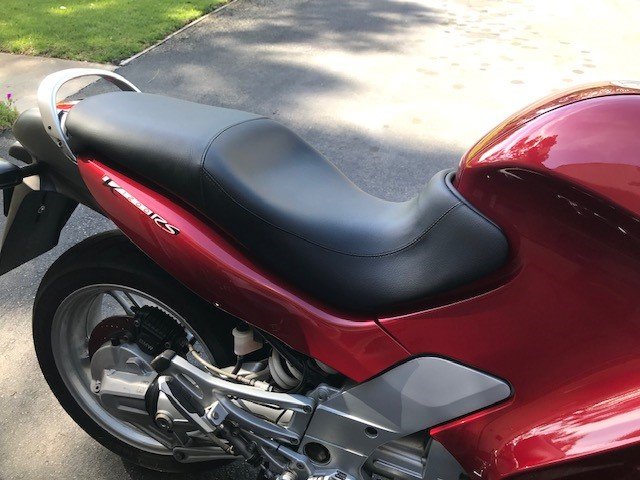

I got the seat back and it looks good, waiting on the two rubber bumpers that mount on the rear of the seat base which I ordered from A&S Motorcycles in Roseville CA. They offer free shipping on all parts which is really nice when ordering small inexpensive stuff. Buying a $1.50 O Ring or a $3.00 speciality fastener and paying $8.00 shipping raises my blood pressure.....
One of the rubber pads was missing and the other one was pretty hardened considering it is 20 years old. For some reason I'm not finding the pics of the under side of the seat. It looks equal to the factory seat. The covering is straight and even and the staples are evenly spaced and in a straight line. Price was $375 out the door for the finished seat, foam, cover and labor.

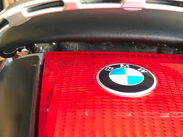

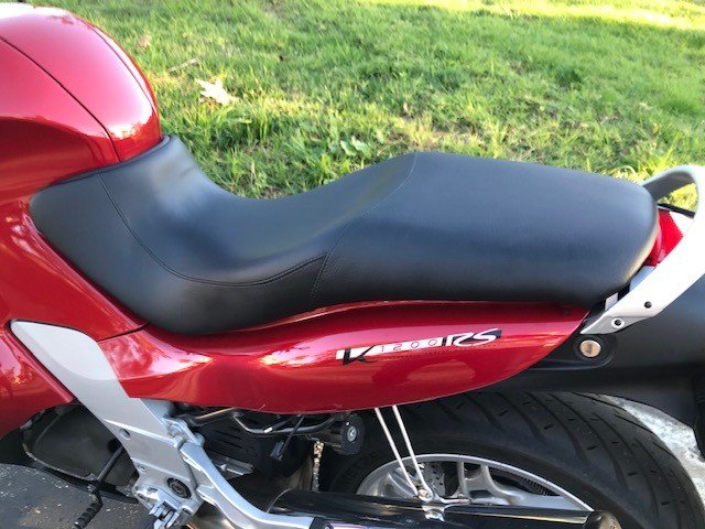

Here's a pic of what I dislike at the rear of the seat, both my original factory seat and the new/old rebuilt seat both expose the seat base and staples at the rear of the seat when looking at the bike from behind. Seems odd (and kinda tacky) that a bike at this price point (when new in 2003) would expose the unfinished seat base...after looking at the way the seat mounts and especially how it "latches/locks" at the rear I realized that lowering the rear of the seat is not an option.

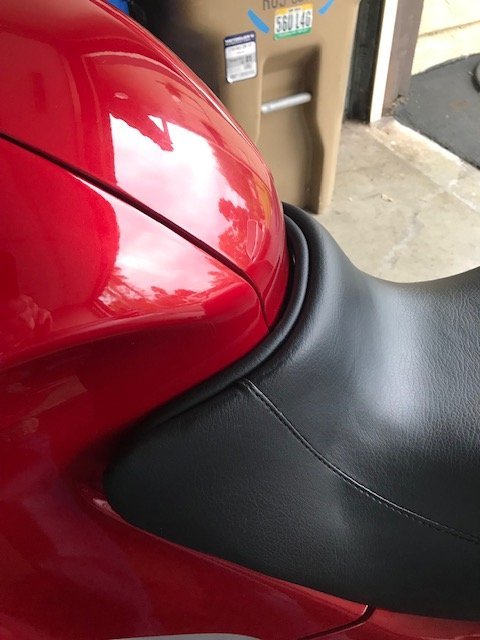

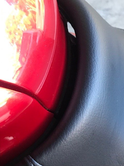

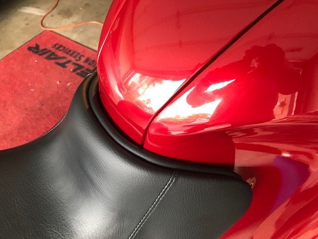

There is also too lage a gap at the front of the rebuilt seat to the fairing shrouding the fuel cell.
I purchased some EPDM Foam "rope" from McMaster Carr (EPDM is very resilient and long-lasting and does not break down quickly) and took the seat back to the shop and Adrian sandwiched the foam in seat cover material and mounted it to the front of the seat (no charge)
I used a larger diameter of EPDM to fill the unsightly gap at the rear of the seat and now I'm satisfied with it's appearence as well at the seating feel and comfort.
I'll post some better pics showing more of an overall view of the bike with finished seat installed soon.

I have two seats for my 2003 K1200RS, one stock seat and one Russell Daylong Touring seat (built on a stock 2003 BMW K1200RS seat pan) and the only way I could get either one of them to duplicate the gap shown in your post(s) was for the seat(s) to not be securely latched onto the rear locking bar. In that unlatched configuration they both showed exactly the same gap, front and rear, as shown in your post(s).

That was my experience on my K1200GT as well. Same seat and bodywork, I never saw that level of gapping.

I put small dabs of soft putty on the 2 rubber bumpers at the rear underside of the seat that should be in firm contact with the "pads" on the rear grab rail and bearing any weight on the seat and after sitting on the latched seat the putty was fully displaced so the seat is firmly resting where it should be.
And my cheap ebay "endoscope" inspection camera (for about $70 these things are incredibly useful if not entertaining as well!) showed that the bar bolted to the seat was centered (fully locked in place) in it's latch and not bearing any weight which is also correct. Both seats exhibit no play or looseness when installed on the bike.
I have no explanation for the rear seat gap.
