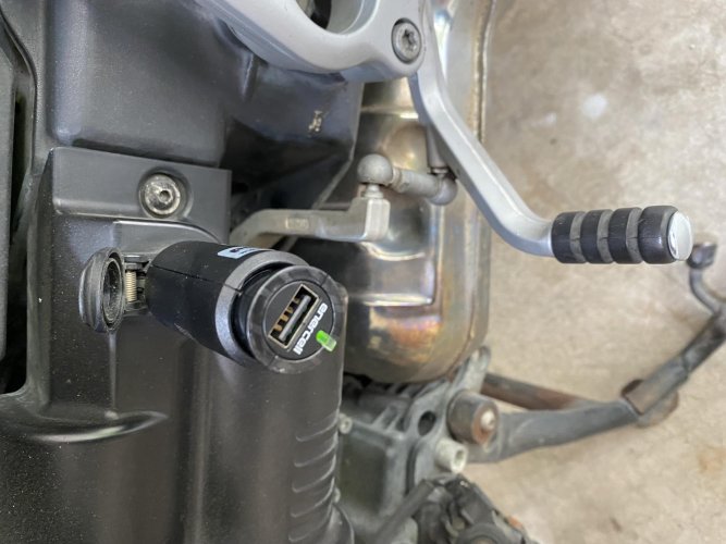

I also flew to pick up my bike and took off for a 3 day trip from there
My 04 has the smaller cig plug hole and I used something similar.
I found it sticks out.
When I got home I discovered it had been wired for a battery tenders so I got the USB end for the battery tender.
