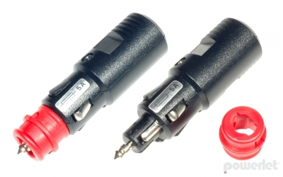

Man, your bike came with an accessory plug and all you needed to do was convert to cig lighter, which can be done with simple accessories such as ...
... which you could graft on to the end of your current power chord and then you'ld have a connector that worked both on your bike and in your car.
See http://www.powerlet.com/product/plug-to-fit-powerlet-cigarette-sockets/279
