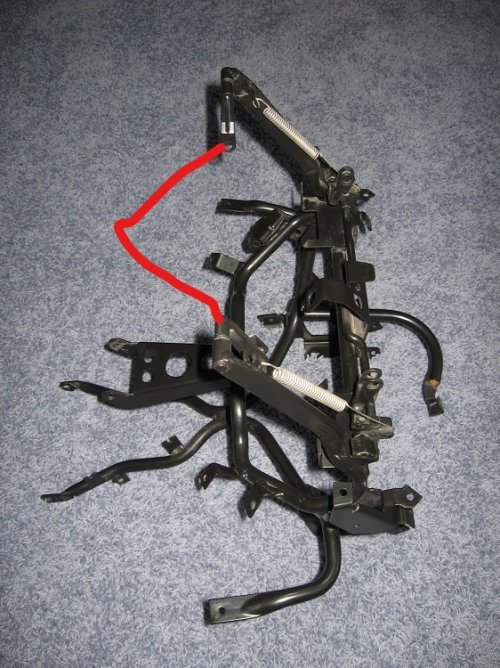

Are you talking about the plastic silver support arms or the little levers I have marked in my picture?

I think maybe the main extra part is the dark plexi deflector. The arms are the issue. Not sure though, since the whole unit came to me this way. What are the springs in your photo?

The springs are hidden inside the silver support arm. They keep tension on the shield to hold it in place.

Actually, it is not the arm that failed. It is the flex f shaft that the arm mounts to, or specifically, the fitting on the end of that shaft. I found part 46632307796 - but that is the older version. I found the rod itself, part 9 in the attached drawing, and the part you referenced, part 8 in the attached drawing. There is an additional fitting, 2 required, that fits into the rod and connects the rod (9) to the crank (8). It also has the crank for the spring as shown in your previous photo. One of those fittings is broken where it clamps to the crank (8). I don't see it in the drawing, and the rod appears to be permanently crimped to the fitting in any case. It seems that the item must be replaced as a unit, the rod (9), and the two ends missing from the drawing.
Part 9 from the exploded assembly drawing is 46637653390, and does include the ends to connect to part 8. Now all it will take is money, time, and effort.😃
