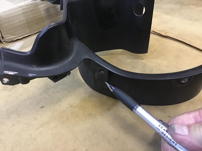

The forward wiring harness (headlight, front turn signals, horn, and instrument cluster) attaches by that rubber grommet, that has one flat side, to the back side of the fairing main mounting bracket COVER. That is the black (VERY early ones were painted body color) cover that bolts to the headstock, goes forward to the bottom of the instrument cluster, and hangs down about 4” from the right and left fairing halves and surrounds the forks. It finishes off the area around the upper forks.
There is a flat pad, on the backside of the cover, with one hole in it, at the forward left side just to the rear of where it necks down from the instrument cluster and starts to widen back out. This pad is only accessible with the left fairing half removed. Place the flat of the harness grommet on the flat of the pad, Run a wire tie through the hole in the pad, behind the pad, back around the grommet in the grove in the grommet and tighten. From there, all the wires in the harness run straight to their corresponding destinations. Going towards the rear of the bike from that pad, the harness follows the backside of the cover back to where it enters the frame to the left of the headstock.

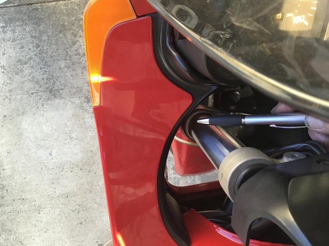

Eville,
The pad is on the back side of this black trim panel at this location:
This is the pad:

Thanks for the pics! The good news is that the part is on the bike. On Max BMW, the part number is 46 63 1 456 139.
I think I understand how this all connects. Thank you for the help. My cover has a small stress fracture in it, near where it joins up with the dash surround area. No terrible, but it does flex enough so that the end near the tank will contact the tank (I added a rubber bumper to that area). So maybe that is why it was zip tied to the lower triple. But I'll see how it all feels coming together.
