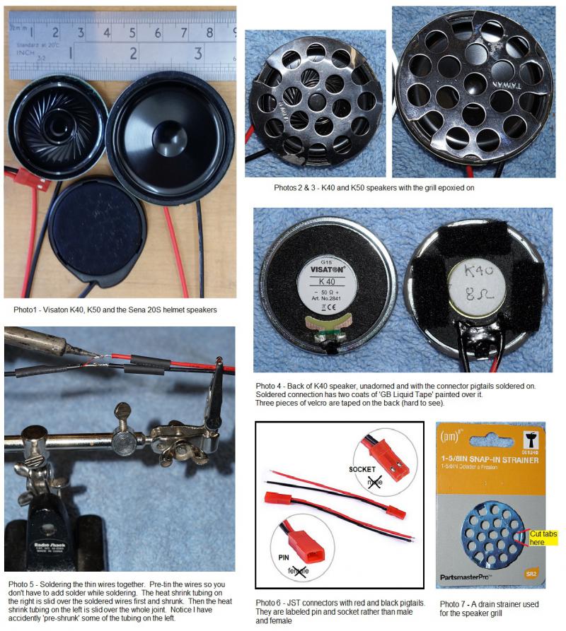

This section is about swapping out the OEM speakers for lower impedance Visaton K40 or K50 FLS speakers. This involves connectors, soldering, a little Velcro tape and a small plumbing part. Photo 1 shows the plain vanilla Visaton K40 and K50 speakers. Photos 2 and 3 show the same speakers ready to mount in the helmet.
The first step is to go to Home Depot and buy 2 ‘PartsmasterPro Snap-in Strainers’, shown in Photo 7. These are cheap sink strainers that will be used as speaker grill covers. The 1-5/8” size fits the K40 speaker and the 1-7/8” size fits the K50 speaker. Cut off the three metal tabs and then epoxy the strainer to the front of the speaker. I bent the smaller strainer into a small dome shape in order to keep the speaker diaphragm from touching the strainer. Be careful to epoxy the grill only on the edge of the speaker and not get any epoxy on the diaphragm. I’m a fan of ‘J-B Weld Steel Epoxy’, which will glue just about anything to anything.
Next solder a connector pigtail onto the back of each speaker. The connector I like to use is called a JST connector and has 6”-8” of red and black 20 AWG wire attached to each connector. Photo 6 shows the connector. I don’t like male and female designation in this case because it is confusing. I have labeled them pin and socket in the photo. You can see the little metal pins on the pin side. Solder the socket connector wires to the speakers. An Amazon link for the connectors is provided below. After soldering, the soldered area needs to be covered with an electrical insulator. Really sticky tape is OK, but I prefer a couple of coats of ‘GB Liquid Tape’, available at Home Depot or Amazon. It is available in colors, but I prefer basic black for most occasions. Liquid Tape makes a broken connection hard to repair though. I haven’t discussed whether to leave the pigtail full length or to trim it. Length depends on how your wires are routed in your helmet and whether you will be using a chip amp, so it’s hard to say. Just “measure twice, cut once.”
Now for the fun part, voiding your warranty and soldering those tiny little wires. Void your warranty by cutting the speaker wires to your OEM speakers. Strip off about ½” of outer insulation from the wires that go back to the Sena unit. Strip back about ¼” insulation from the two inner wires. You can strip the insulation off of the two inner speaker wires or just burn off the insulation with your soldering iron. Photo 5 shows this.
Now solder JST pin connector pigtails to the speaker wires that go back to the Sena unit. Be sure to use pin connectors this time. Strip back ¼” insulation from the red and black pigtail ends. Slide two pieces of heat shrink tubing over each pigtail wire and another over the black Sena speaker wire. You only need a small pencil soldering iron. Harbor Freight has a 30-watt unit for $4. Harbor Freight and Amazon have heat shrink tubing kits for under $10. The easiest way to solder thin wires is to put solder onto the wires and then place them side by side and solder them together without adding more solder (again Photo 5). The trick to soldering is to make sure that you melt fresh solder onto the soldering tip just before you use it. You can tap off any excess. Fresh solder has fresh flux that isn’t oxidized. Having a ‘third hand’ helps too (see photo and parts list below). After the wires are soldered, slip the heat shrink over the wires and shrink the tubing by holding the soldering iron close to the wire.
If you want to, solder the socket JST connector pigtails to your OEM speaker wires so you can compare the new and old helmet speakers. Put some Velcro tape on the back of your new speakers, connect the speakers to the Sena wires at the JST connectors, and fit your new speakers back into your helmet. The K40 speakers are the same diameter and possibly a bit thinner than the original speakers. You can use the foam covers that came with the Sena speakers to cover the K40 metal speaker grill if you wish.
Just remember, socket connectors on the speaker wires and pin connectors on the Sena wires.

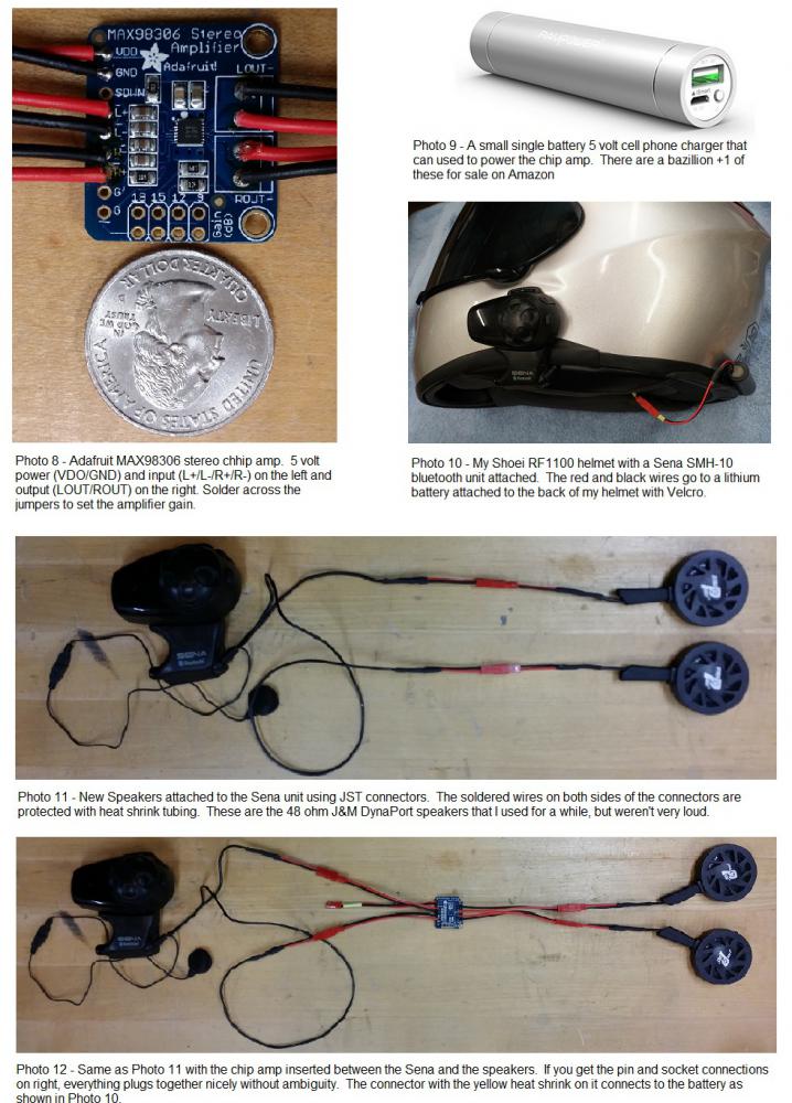

Adding a chip amp between the Sena unit and the speakers can add a lot more loudness to your speakers, as demonstrated in the TESTING section of my first post. I’ll give more general directions here as I assume this mod will be tackled by those with some tinkering experience.
The chip amp I used is from a company called Adafruit (ay-duh-fruit), adafruit.com. There are plenty of other 5 watt chip amps out there similar to the one I used that are probably just as good. I just like and trust Adafruit. They have plush toys of Cappy the capacitor and Hans the 555 Timer IC that I got for my granddaughters. Check out Lady Ada if you dare! Photo 8 shows the little chip amp with all of the connections, 4 wires input from the Sena unit, 4 wires out to the speakers and two wires to 5 volts power. All of the wires are pigtails from JST connectors. The input wires have socket connectors and the output wires have pin connectors. In the photo none of the gain jumpers are connected, so the gain is at the default of 6 dB. When I was done I put some large diameter heat shrink tubing around the amp board and shrank it down so the wires stuck out each end.
Photo 9 shows a little external cell phone recharging battery that you can use for power. You just have to cut a micro USB cable and attach JST connector pigtails to the +5 volts and ground wires of the cable. I used a lithium battery and separate charger from Adafruit, but I think the cell phone charger is easier. I don’t know the pinouts of a micro USB connector, so you will have to look that up. The battery can also be used to power or recharge your Sena unit. My battery lasts 2 or 3 full days between charges. Photo 10 shows the wire from my amp to the battery that is velcroed to the back of my helmet. I attached some yellow heat shrink around wires on both sides of the power connector to make sure I plug the battery into only the amp power supply wires. I turn amp power on and off by plugging and unplugging the JST connector. The battery weighs about 2-1/2 ounces.
Photos 11 and 12 show the mods with and without the amp inserted. You can do the whole setup with just pigtail wire and the wire that already goes to the speakers. The amp and wires are hidden behind helmet padding and only the wire to the battery is exposed. (The wire lengths from the amp to the speakers in Photo 12 are wrong as one wire will need to be longer in order to reach the far side of the helmet.)
