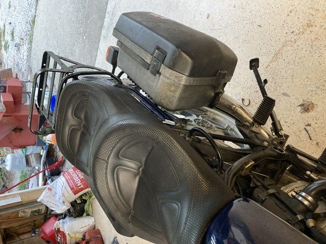

I have a 1988 R100RT the luggage rack on the bike is not very robust. I purchased a Model 231 Reynolds’s Rack which is supposed to bolt right on, my question what should I do first? It looks like removing the seat, the rear cowel and light assembly possible starting point perhaps not necessary?
Any help would be greatly appreciated thanks in advance.

Is powerlet socket using a attachment point.
Edit the Reynolds’s rack bolts right behind powerlet socket

I guess I don't really know how to help putting this on. Seems like the cowl in the back is going to be an issue.

I will get some good pictures to help future airheads. I took the seat, cowel and all the back lights off it looks like my 231 rack will bolt up I do have the s style racks that fit the k bags and have verified that a set of k bags will work on my mounts only difference the k bags have one more latch to hold them closed

Success
6E2BB9BC-8837-4CA0-BC45-76E4B72F4D19.jpeg1494C1A8-4170-4BF9-AD7F-3E5C7CA48796.jpeg6835A92F-D30D-4D6A-9086-652ECB5D8B35.jpeg
Reynolds’s model 231
Photo #2 back of bike with saddle bag racks bolted on remove S racks
Photo #3 side racks reinstalled
Photo#4 s bag rack before Reynolds’s install
Photo#5 s bag rack after install
Photo#6 K100 bag attached to bike
Photo#7 original bags that came on 1988 R100RT
