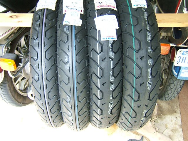

I wanted to get a couple of my airheads back on the road and thought replacing the old rubber would be a good idea. I normally by the 3.25x19 front and 4.00x18 rear but could only get the metric this go around with the Bridgestone S11s. I've read on this forum and other places that front tires go any where between 90/90x19 to 100/90x19 and the rears 110/90 x18 to 120/90 x18. We since I'm putting rubber on two bikes I bought a set of 90/90 front and 110/90 rear for one bike and the larger size for the other. The 120/90x18 rear really looked huge when I got it, and I think I might have a problem mounting it. Attached is a photo of the four together, L to R 90, 100, 110, 120. A casual measure of the tires at their widest profile is 3.85", 4.18", 4.57" and 5.04". Has anyone put (successfully) a 5.04" wide tire on a 84 R100 Airhead before?

Dave, for whatever its worth, I have a Metzler Lasertec 120/90 on my '83 R100 and it just barely clears the swingarm. Its a bit of a wrestle to get the wheel back on, but deflating it helps. You can also (carefully) move the swingarm a tiny bit to help.

Just had the 90-/90 and 100/90s mounted today. The 100/90 looks right, the 90/90 is quite a bit shorter than the 3.25 and looks a little odd on the front. I'll take it out tomorrow for a drive to see how it feels. As for the rear, the 120/90 is so tall in addition to being a little over 5" wide, I don't even think I will mount it.

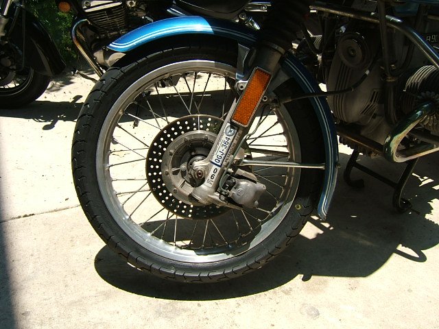

Here is the front tire (90/90) mounted. Took the bike for a short ride. Steering feels OK.
Dave H

The 100/90 looks like it has the same height profile as the 3.25 and the 110/90x18 in the rear looks to have the same height profile as the 4.00. A 120/90 is really tall, maybe should be replaced by a 120/80 if the width works. I just wish they had more options in the inch series. I would stay with 3.25x19 and 4.00x18 if more tires came that way. BTW, the tire I took off one of the bikes was a 120/90-X18 Metzler. Be careful, different manufacturers have different spec it seems. Anyone what to buy a brand new 120/90X18 Bridgestone Spitfire 11?
