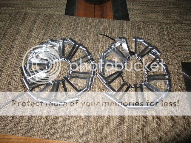

Help is on it's way,,Made up a set to test out,,,,
Just picked up a pair of these upper struts from Beemer Boneyard and installed a ZTechnik Z2402 windshield with them. They seem well made and fit like a factory part.
I did notice though that the bottom flat side of both arms touches the black plastic on top of the nacelle in the full down position. I can see the side wind deflectors and my Migsel GPS mount flex just slightly as they push down on the plastic. Anyone else with these mounts notice this? Doesn't seem like it will become a long term issue, but I was slightly surprised that there was any contact. Perhaps that is the price you pay to have stronger struts that won't snap with the added air pressure generated by larger aftermarket shields.

Just to share publically... After posting about the upper support arms contacting the plastic on the nacelle, Tim, the maker of the 10OVR brackets being sold at Beemer Boneyard, offered to send me a new pair after reading my post. I appreciate when companies stand by their products and would try the lower brackets in the future as well. I'll report back on the new upper brackets when I get them installed.
Tim, any other people notice this or were mine just cut slightly large?

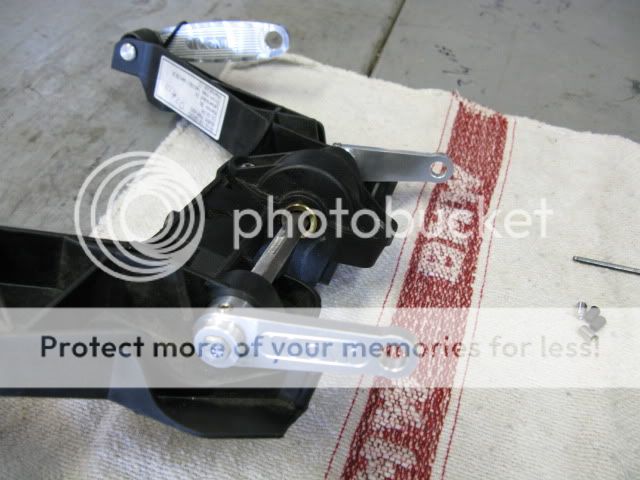

It's not a hard job,,,,
1,,Remove upper side panels
2,,remove windshield
3 pull pins (4) to remove bracket that windshield bolts to,,
5 pull off rear view mirrors
6 remove interment cluster cowling
7 Unplug head light and turn signals
8 Run windshield motor to down position
9 remove head light assembly (4 bolts with big washers as seen in pix)
10 Remove windshield motor assembly (8 torx )
Now you have the motor assembly on the work bench
11, I use the face of the cut off wheel to clean up the ends of the hex shaft ( You could also use a dremel tool or file to do this,(,I think BMW pressed the ends of the hex shaft to keep the arms on,)
12,Tap the hex rod through with a small hammer and punch
13,,clean up hex rod with a little emery cloth and Install new arms and tighten down allen's ......
14 put in all back together and ride,,,

Lower Arm Removal
The arms on my 2006RT have circlips holding them on. After removing the circlips, I used a screwdriver to pry the arms from the shaft. It did not take a lot of pressure to remove them. Apparently. BMW used different methods to secure the arms over the years.
Prying the arm off
Replacing the windshield bracket on an 06 RT

Great information. I'm a newbie with a broken upper arm, but plan to replace both sets of arms on my 2006 RT. Two questions:
1. Is it really necessary to remove the windshield motor assembly? The hex shaft seems completely accessible while still attached to the bike.
2. Re: the ends of the hex shaft being "pressed" to keep the arms on and cleaning up the ends with a file...If the ends of the shaft are already clean, should the arms be easily pried off or does pressed mean that a little bit of metal must be filed off each of the six faces of the hex shaft, on the outside of the arms, to enable the arms to slide off the shaft? I'm leery about forcing anything. How about WD-40?
