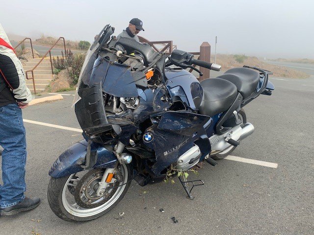

We had 1 great 7/8 of a day riding, then had to head back home. My buddy put his bike in a ditch, and totaled it. H is fine, bike is gone. I ended up renting a U-Haul to get my bike home, as he had a pretty badly swollen knee from his flight over the handlebars.

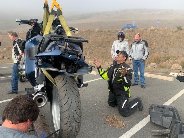

now he is trying to figure out when to get a replacement. Never a dull moment!
Good to hear that he is OK. A beautiful R1150RT was sacrificed however!
