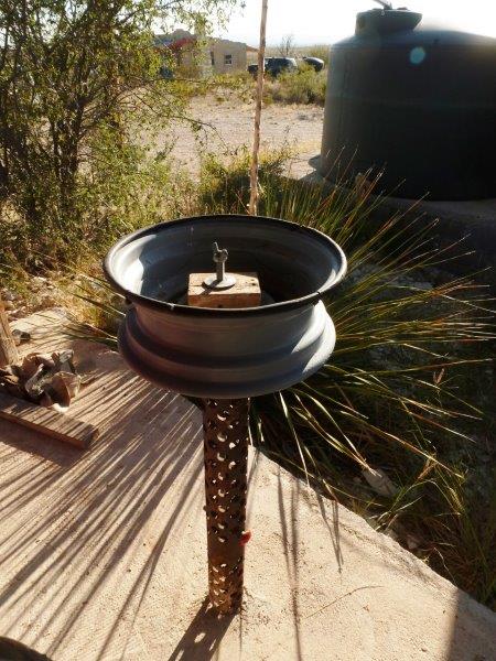

Do you have a picture?
OK, here is a photo I took today.
The perforated pipe was already in the floor making the project easy. I welded the wheel to the top of the pipe and cushioned the rim with a split hose.
The center hold-down is a threaded rod with a loop on the bottom end. It can be adjusted as needed with the cross-pin which is visible, but barely, in the photo. I use Motion Pro tire irons.
It isn't a Coats 220 but it beats kneeling, working on a wood box.

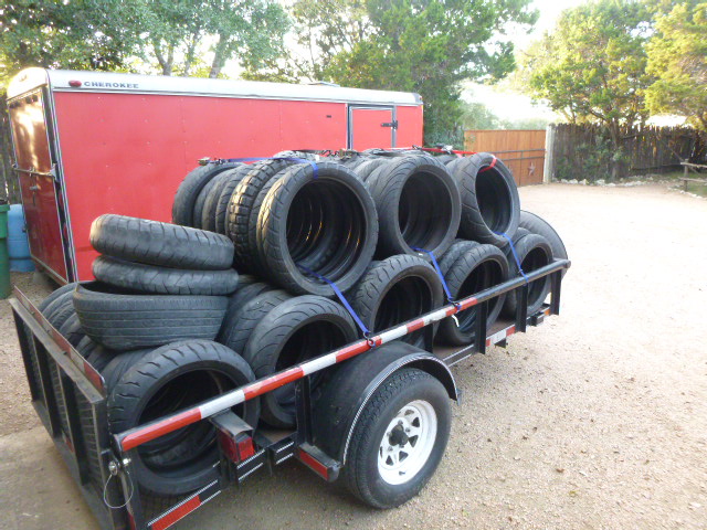

Not only need room for a changer...but some of these as well if you are popular:wave
Waiting on trip to recycler/shredder 100 miles away next week ...no ride day:bluduh
