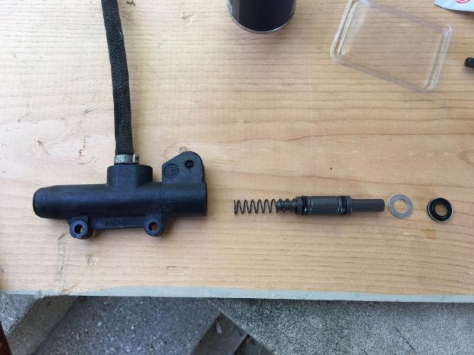

I ordered a new master cylinder rebuild kit and a new oem brake hose. I'm in a situation where when I test assemble the rebuild kit, and insert the plunger/piston assembly to the point where it will be after seating the interference ring, it blocks the reservoir hole and no air can be blown into the master cylinder. But if I back it off, air will pass. I've done a TON of reading on this and I'm pretty sure I have the assembly correct, and I've done other master cylinders (very similar) before with no issues. It feels like the piston assembly is too long, like maybe I got the wrong part. But I compared it to the old part which matches exactly. In fact, the old part still looks pretty darn new. And considering the rear brake pads look basically unused, I have a suspicion that the brake never worked at all. After all, if one blocks the supply orifice, how can it provide fluid to the system?

That piston looks shorter to me. Right now, unless someone can show me where I screwed up, I think I need that shorter piston assembly. I ordered it through Bob's, and the guy on the phone didn't offer up options, so I "assumed" it was the correct part.
I would be grateful to be proven wrong so that I can install what I received and get this bike back on the road.
Edit - So I called Bob's to get their insights. There are two different rebuild kits - essentially a 14mm and a 15mm. I measured mine and it's a hair over 14mm and the m/c body has a stamp onit "xx -14", implying it's a 14mm m/c body. Also, there is a date stamp (I think) indicating "81", so 1981. Bob's told me the 15mm kit is for bikes up to 1980, so this all makes sense. Except for the part that it seems to be blocking the orifice.
What's the kit number that you ordered? RealOEM indicates it's 34211242791.
Yup - that's the one I got. Again, maybe I just am missing something. But any master cylinder I have done in the past puts the plunger behind the orifice allowing for fluid to fill the chamber as well as the entire circuit. I can certainly assemble this as delivered, but it places the plunger forward of the orifice and it seems to me that if the orifice is blocked by the piston, it won't allow fluid into the circuit. And again, I would love to be proven wrong.

The rebuild kit is correct - no real surprise there. I was also correct, that one should be able to blow air through the orifice, but it wasn't the piston blocking it. It was clogged. Apparently common. There are two orifices - 1 large and one small. The small one is really small. I had to pull the bung out of the top with the supply hose, and use a fairly fine needle (thanks Grandma!) to clear the hole. Then I blasted it with carb cleaner. I then assembled the master cylinder and I was able to blow air through the small orifice (could sound strange in a different context).
With the entire system assembled I was easily able to draw brake fluid through using a 60cc vet syringe sans needle of course. The brakes now work, albeit a little spongy. I'm told that if I wedge a 2x4 over the brake pedal and under the cylinder it will allow air bubbles to escape overnight. i'll report the results later.
