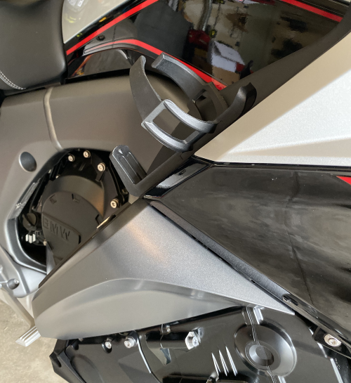

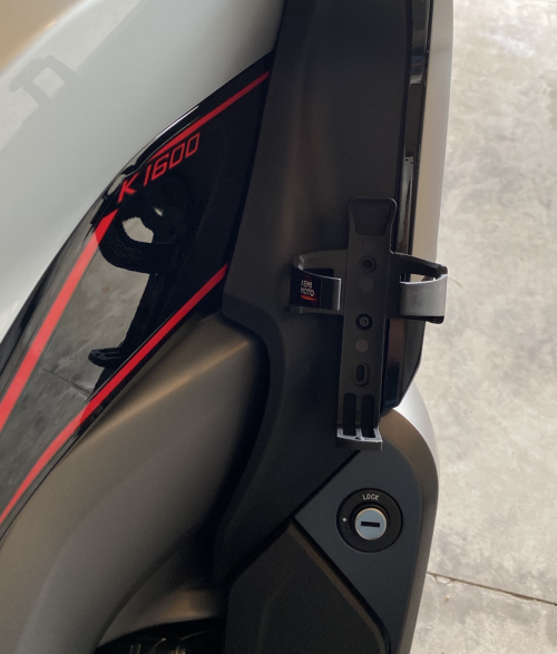

Ok have to say - found THE perfect cup holder solution for coffee on the road. All of what I used was ound ALL of this on Amazon:
1 - Kemimoto Cup Holder - https://tinyurl.com/yypsa8ef
2 - M5-.8 x 20 Allen screw - https://tinyurl.com/y4aaz8ns
3 - Contigo Travel AutoSeal Coffee Cup - https://tinyurl.com/yxqygusw
Simply remove the right side plastic M5 panhead screw above the right locking compartment.
Take the clamp off the Kemimoto cup holder and attach only the holder with the M5 screw to the bike (I tossed the clamp!)
Works perfectly and seems to match the bike pretty well. Cup is easy to access and easy to put back in place.
