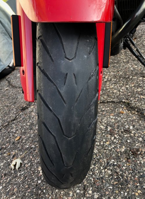

Here is mine, the tire is Pirelli Angel. Just regular road use but looks like off of a racing bike going around and around to the left.
Forgot to add that none of the above explanation works for this because I rode a Yamaha bike for 8 years - including daily commuting - prior to owning the BMW and this irregular wear pattern never occurred on that bike.
That front left side wear pattern is an Oilhead thing. Several things you can do to reduce it significantly. I own an 1100RT (Oilhead) and two Airheads. They get the same treatment (by me), on the same roads, and the Airheads do not have that kind of tire wear, never did.

So what are those mysterious things I can do to reduce this
Easy, no-cost things. Add extra weight to the left saddle bag, or shift weight out of the right. Run higher pressure in the tires. Don’t know what you are running now, but the factory PSI recommended is too low. Try running near 40 psi in both.
If you still have the original Showa shocks, especially the front shock, consider upgrading to a higher performance shock.
Try different tires. I run the Pirelli Angel GT rear. I tried the Pirelli on the front once. It wore much faster than other tires I have tried. Not the excessive left side wear, it just wore out too fast. Tires that have worked best, for me, on the front, Dunlop RS4, Michelin PR4 GT.
