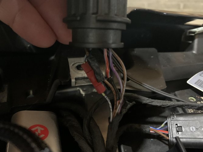

I’m trying to tie into the BMW brake light for the top case that came already wired, but I’m having a hard time figuring out the wiring colors! They’re different from my 2016 RT and I can’t seem to find anything on the Internet referencing which color does what? Need help!

I don't have a 19R1250RT but according to Real OEM your 16R1200RT takes the same top case, the wire is same. Did you have a central locking on your 16 RT?

Not having a R1250RT I can't look at it at this time. The wiring for the rear tail light is:
Blue/Black: Right turn signal
Blue/Red:Left turn signal
Grey/Red: Tail light
Grey Black with Yellow dot: Brake
Brown: Ground

Do you no which is power, I think it’s the red/gray but when I connect to it, the lights work the way there supposed to but they never shut off. It’s like that’s power on all the time! I’m confused, I no BMW STAY on for like a minute to 30 seconds, but these never go off. As you can tell I’m electrically challenged!

Red/Grey is the tail light should be off when the bike is off.
I’ve attached a picture of the top case connector and wiring colors I’m trying to connect to the skene IQ-260. You can see where I cut the gray wire according to skene’s diagram, but the colors are different from his diagram.

I got it , tied into the rear power socket, it takes a minute to shut down but I can live with that!
